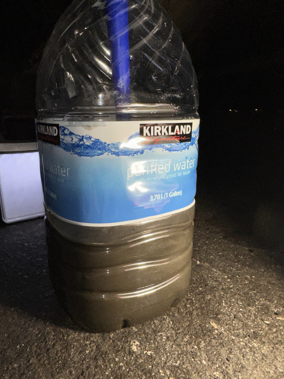

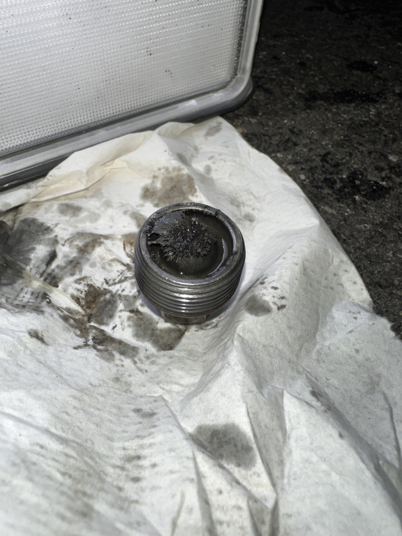

            So it was the pilot bearing , when I dropped the transmission the pilot bearing was flush with the top but I also drained my fluid and found this?? Metal shavings and grey fluid
                What do you mean "flush with the top"?
                Did you confirm the pilot bearing was the right inner diameter for the transmission?
                Fluid doesn't look good, but perhaps it has been a long time since it was changed. Might be worth fresh fluid to see if things improve (make sure you use the right type, some boxes actually take ATF even though they are manuals).
