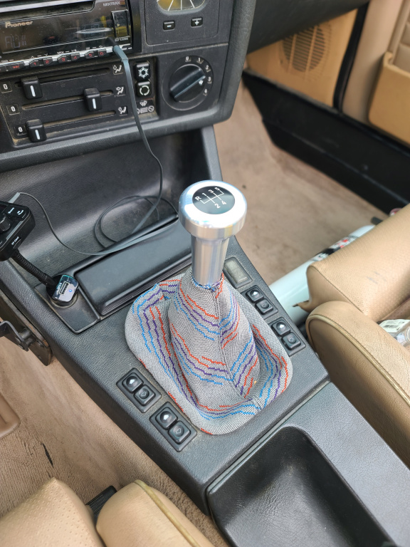

    Last fall I installed the garagistic solid chassis mount shifter, dssr, and New shift linkage. When installing the shift linkage, I think I bent the detent and the transmission according to what the guys at garagistic told me after I describe my problem to them.
    basically all of the gears have shifted to the right. First gear sits where third gear used to be, third gear sits where fifth used to be, and fifth gear is way the heck over in the passenger’s lap basically. it seems like this isn’t an unheard of problem in the BMW world; colloquially called fifth gear Lean.
    I was wondering if anybody knew a part number for the detent pins for the transmission for the 240. In my Internet sleuthing, I’ve only really ever found detent pin kits for the E36, And never anything specifically saying that it’s for the e30.

    So the classic E36/E46 5th gear lean is where the detents don't push the shifter back into the 3-4 gate.
    What you have sounds different, and the detents won't fix it. Bending the selector rod inside the transmission
    is possible, but dang, you brute!
    After making sure everything else was right, me, I'd just bend the linkage rod between the shift lever and
    the transmission to compensate. Or cut and weld it. Or make a specially- clocked one for that transmission.
    That has the lowest chance of causing further damage.

      Concur, the issue can be solved in the external linkage. Either the setup is wrong, or the manufacturing of the parts was faulty, maybe both. Adjust it until you're happy.

          I've never heard of that being a problem with G240s. Did you verify that the selector rod joint is canted when it's in third gear and the problem is in the transmission? With bad detents in a ZF the does not even go into all gears without a fight, that's how the ZF310 in my E34 was when I bench tested it before I installed new detents and put it in the car. It didn't shift fine just with the wrong angle.

            it doesn’t seem to have any trouble going into gear, but it just leans to the right. basically it functions, but all the gears seem to be the next gate over.
            maybe I’ll try putting an extended bolt in offset the linkage from the bottom of the shifter 🤔
