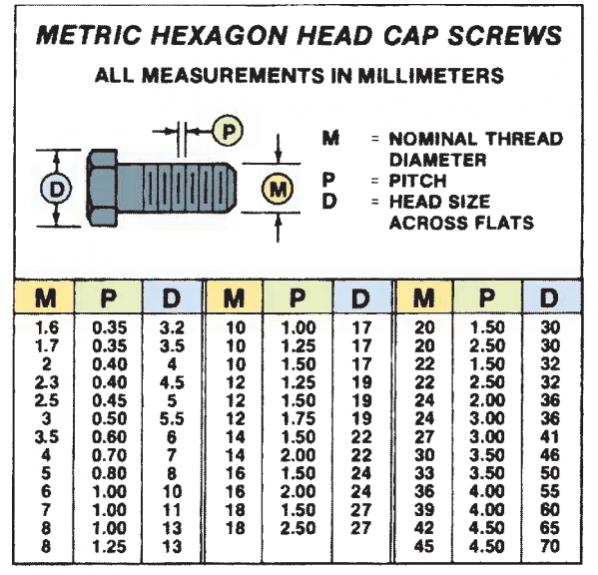

          Actually, I don't even own any impact sockets and I didn't want to buy a whole set.
          Guess I could have looked here..

            I just use normal sockets on my cordless impact......its only an m12, it cant be that tight.
            I wouldn't put too much faith in that table, just take your socket set.....
