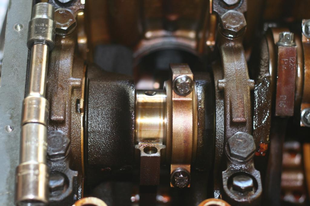

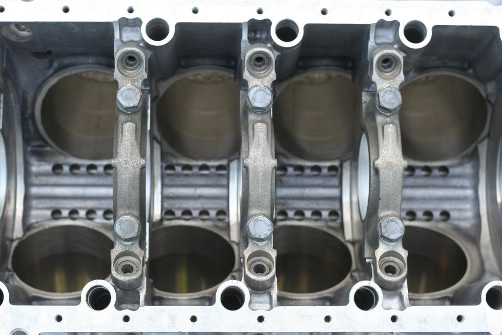

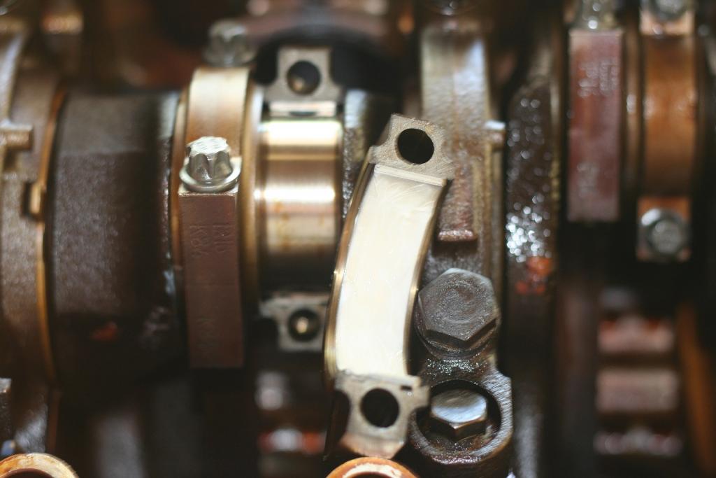

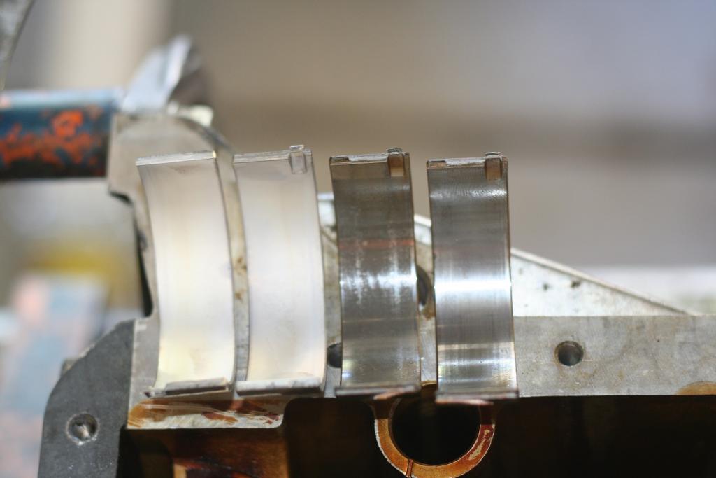

                  Replaced the rod bearings and the rod bolts today, cleaned up the block a little bit.
                  In the two weeks I should have the bottom end done. Have all the parts, just need to assemble the oil pump and find where I put all the bolts for the oil pan(s).

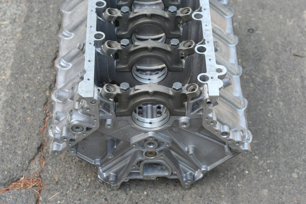

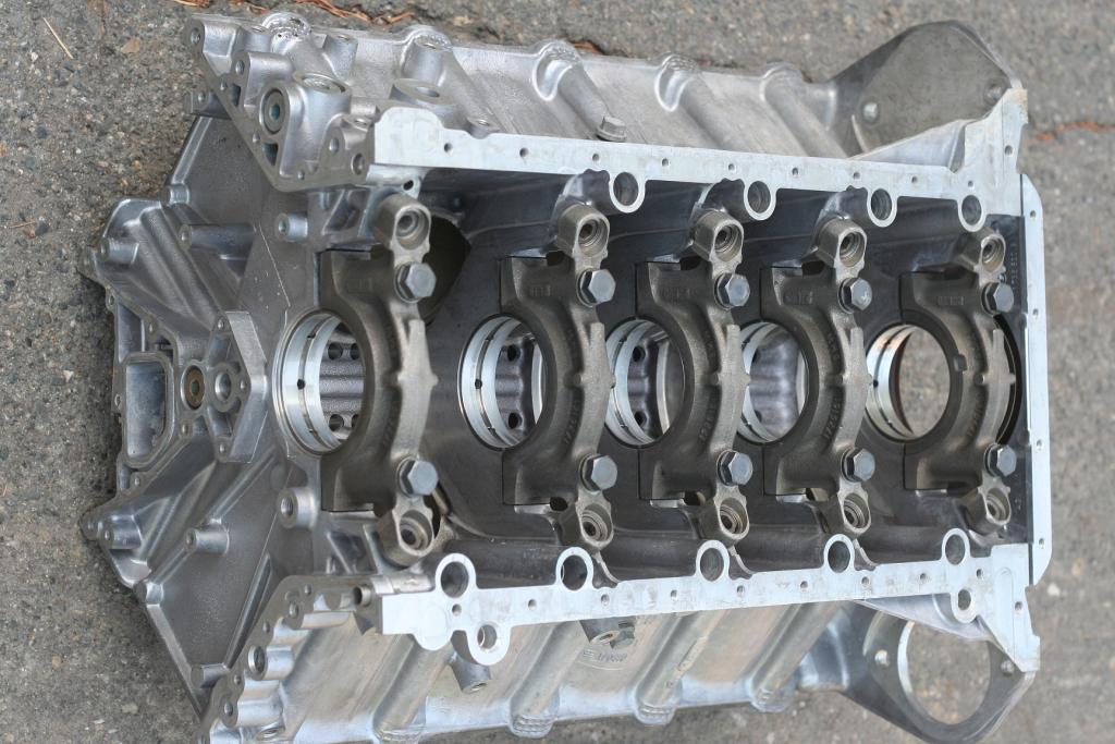

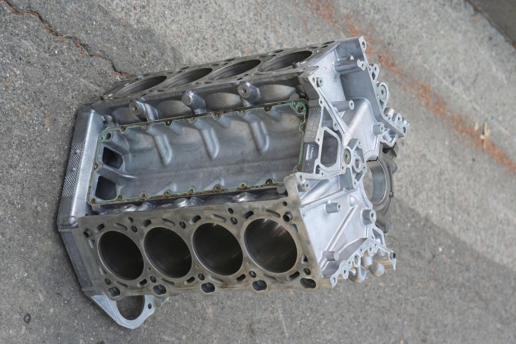

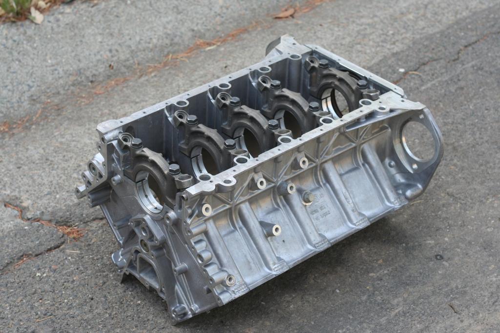

                    And here is a spare m60b40 block that I had hot tanked for my brother to use as a 'coffee/wine' table.
                    Looks damn minty, and it's sooo light!

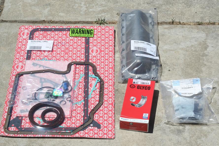

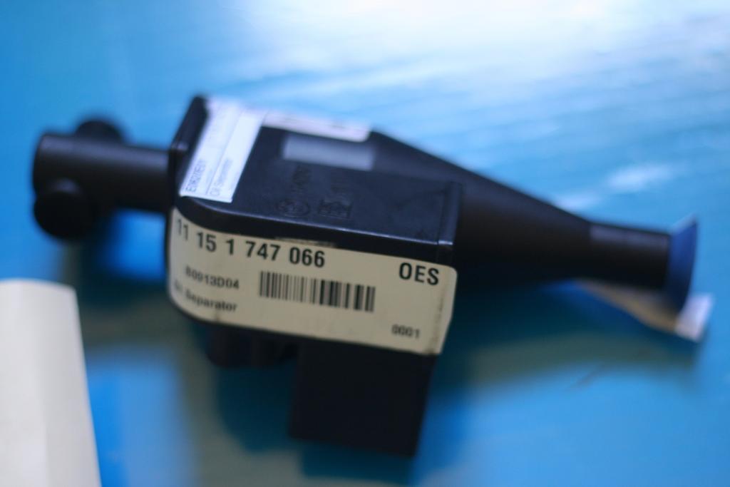

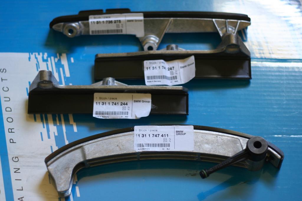

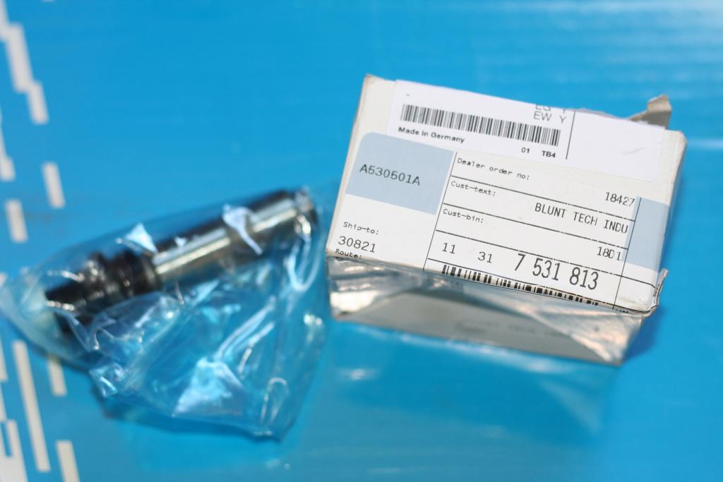

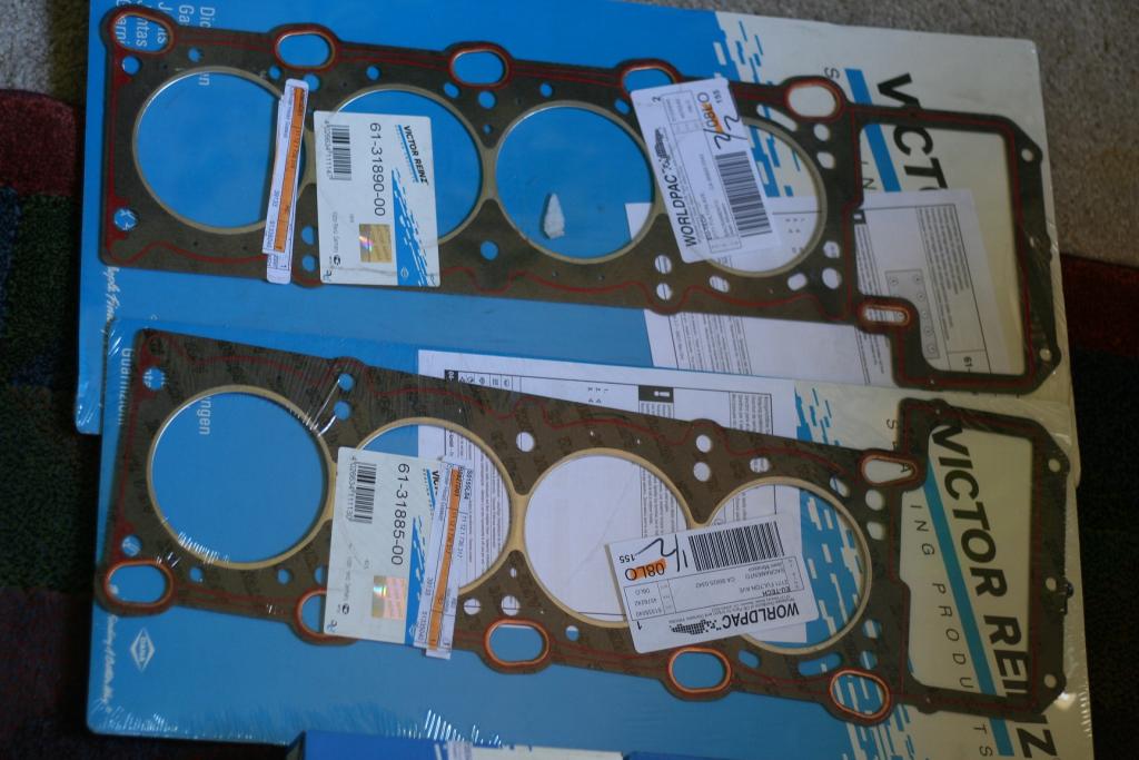

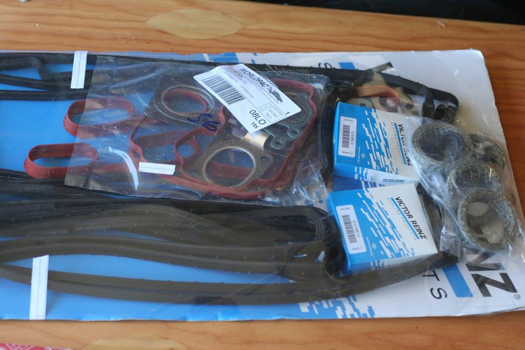

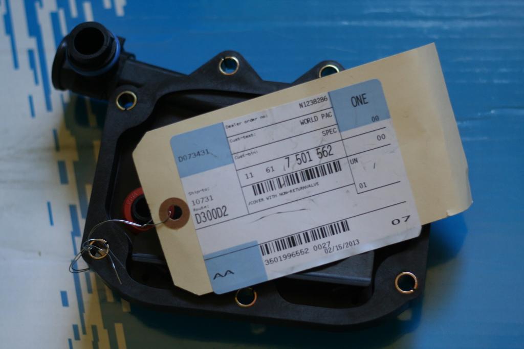

                      So here is where I am at now with new maint. parts on hand, still have some more to go.
                      - upper gasket kit 200
                      - lower gasket kit 130
                      - rod bearing set 82
                      - rod bolts 87
                      - timing guides and tensioner 260
                      - valley pan 75
                      - head gaskets 100
                      - head bolts 40
                      - oil separator 35
                      - egr valve 56
