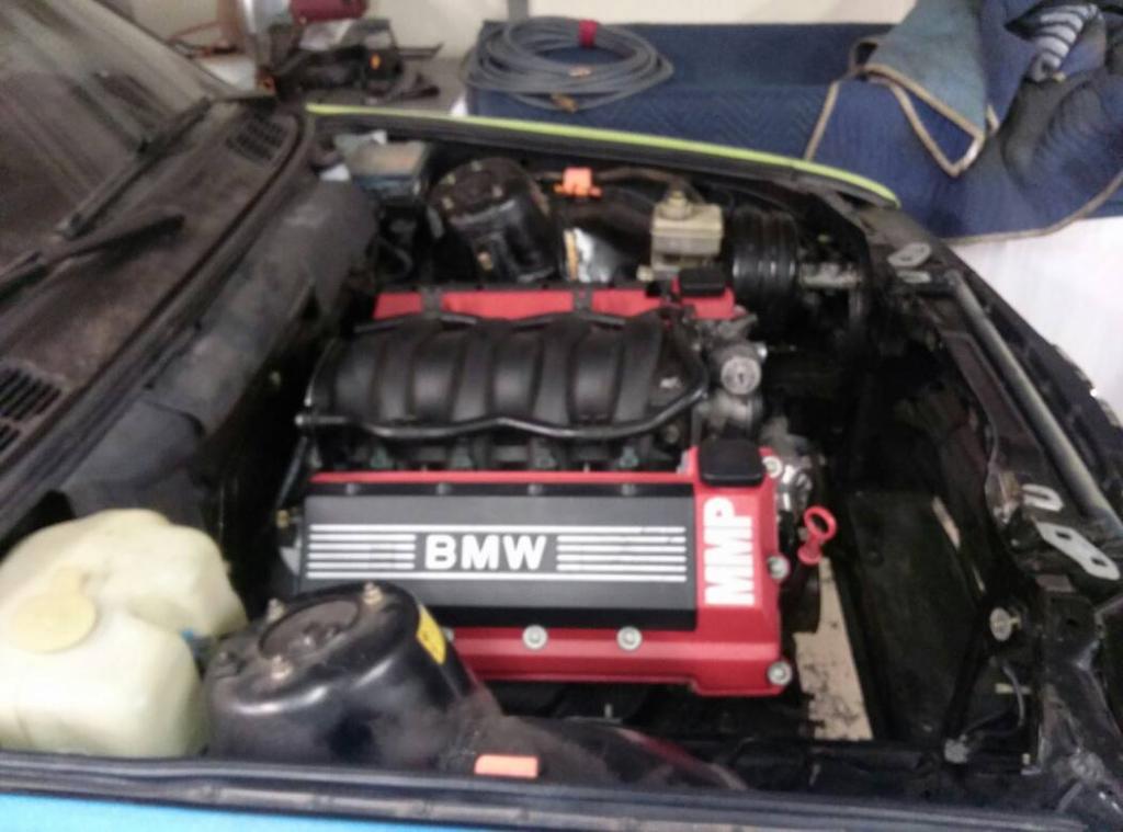

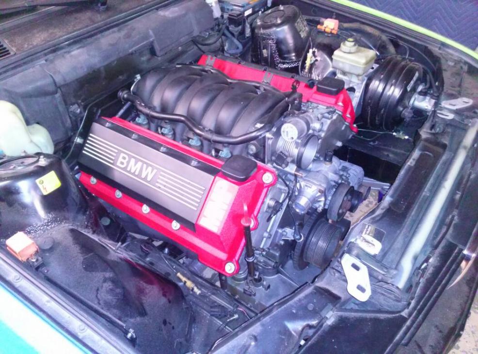

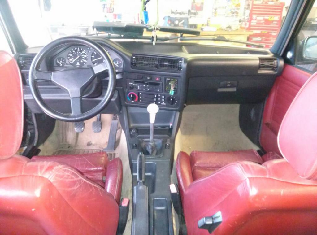

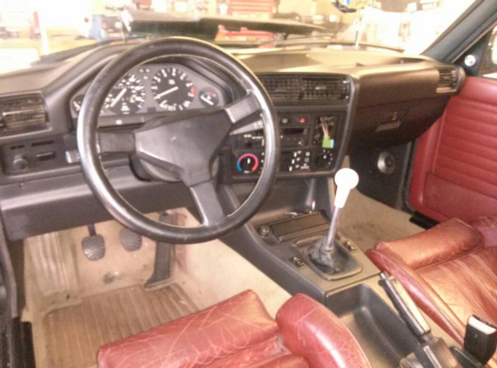

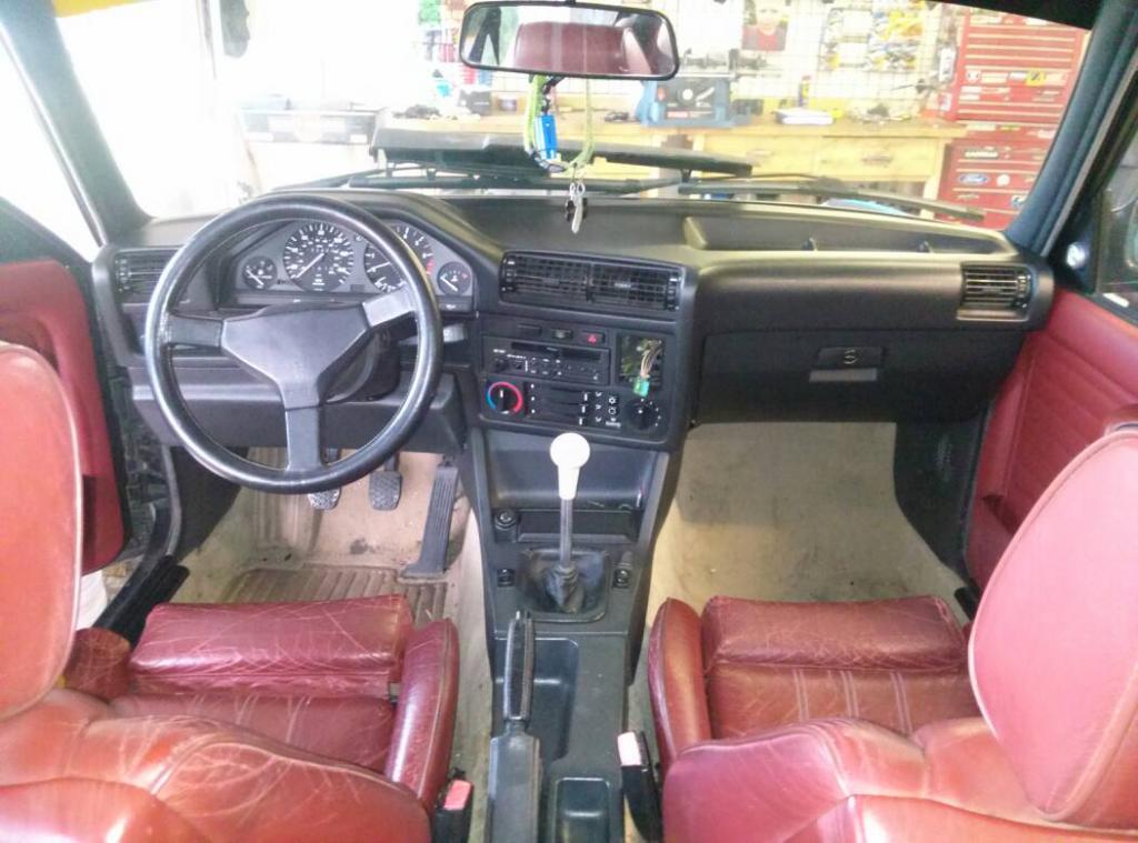

    Soo the dash is is all back together finally..
    Just waiting on my damn euro clock from "Fusion"
    I think i got screwed, the guy has fallen off the map. Looks like I'm out $60...
    So if you got a euro clock for sale. Let me know....
    Now some pic's

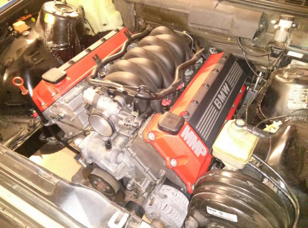

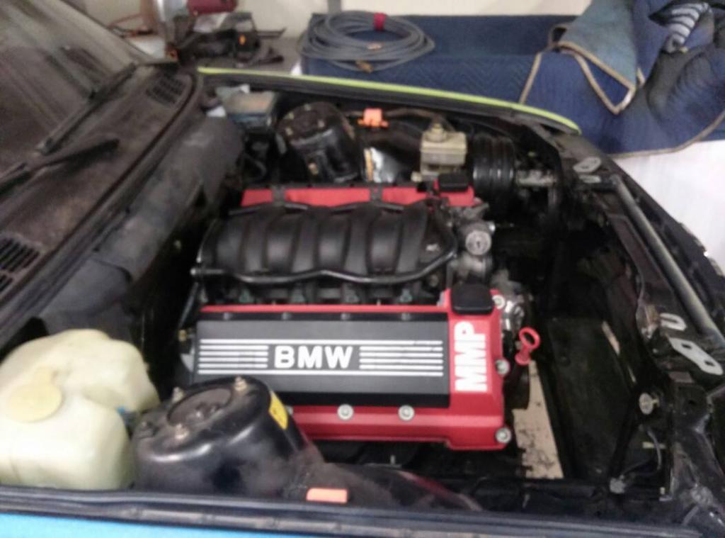

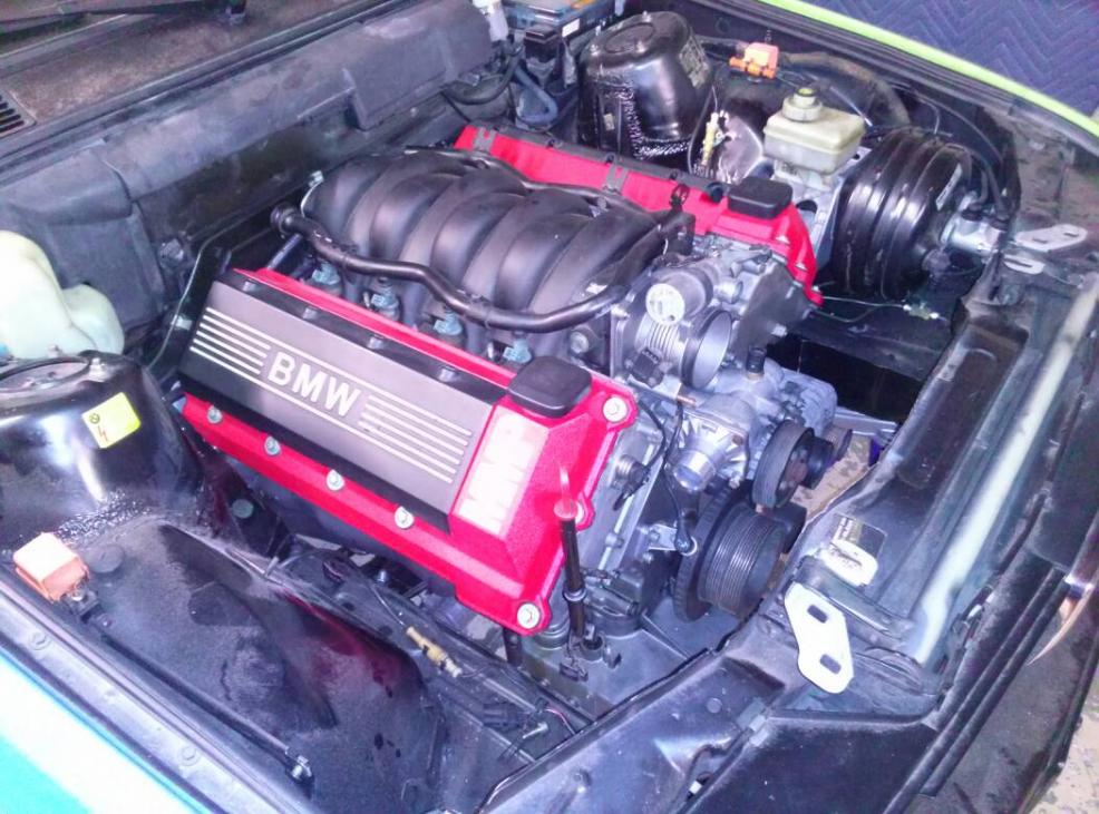

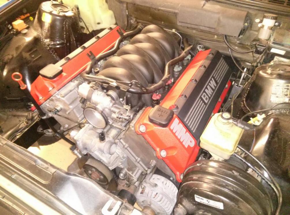

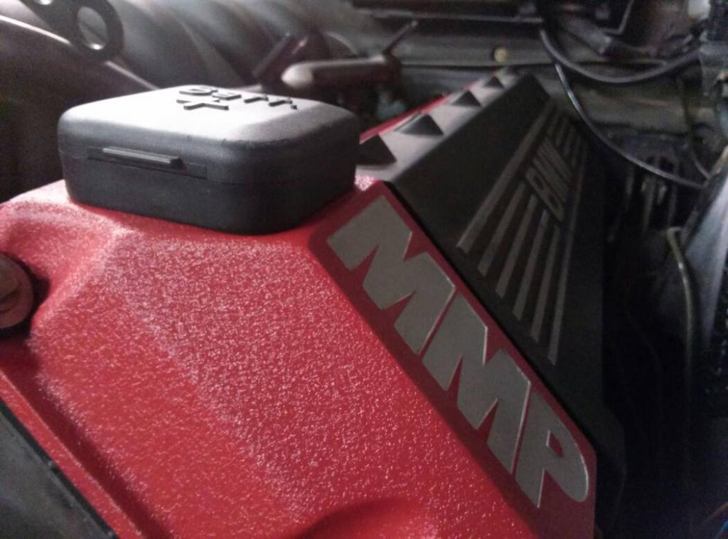

        Well fixed the cam sensor issue. Resealed the motor and now ready to button up the build.
        Its now more about the little things.

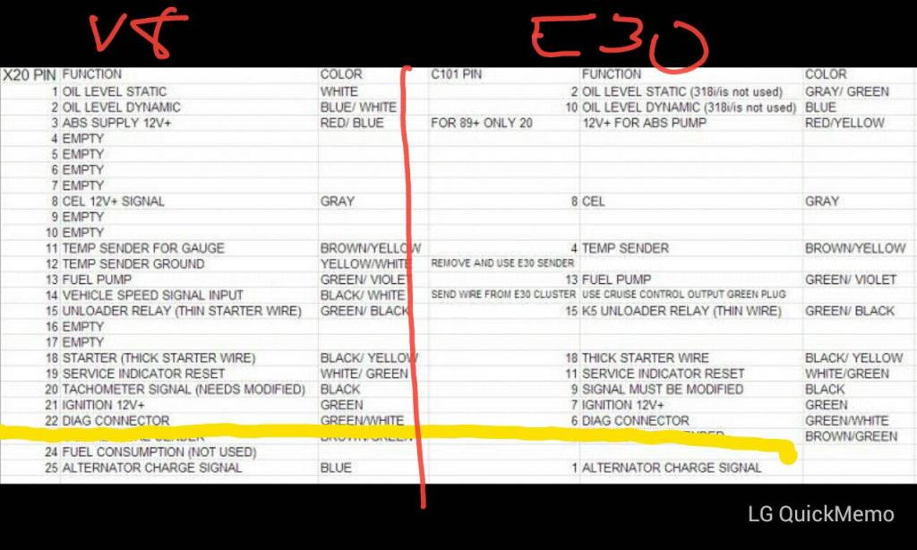

        One thing i am holding off on is the harness.
        Still have a few bugs to work out with it.

            Originally posted by filthiest e30
            Great progress, the engine bay looks great! Regarding the harness I saw that you commented on Andrew325is plug and play harness thread, did you end up buying one from him?
            Thank you.

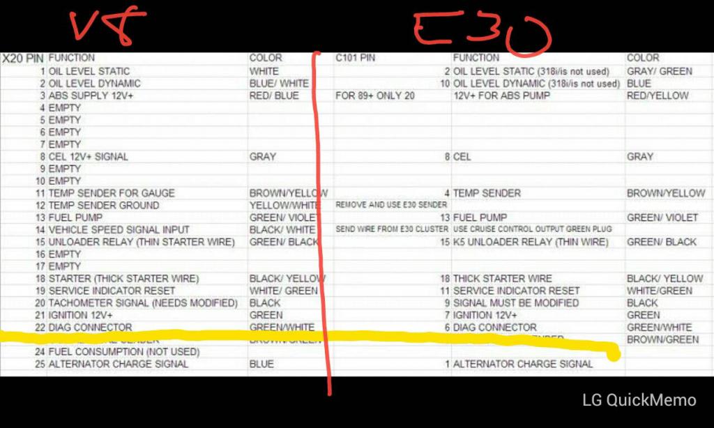

            No i did not. I haven't found what i was looking for by way of the harness. So I'm working on my own. I built one that fits my need was really ,excited till i read another thread here in the v8 section mentioning pin #6 the hot wire for the o2's a wire i forgot. I got frustrated and have not revisited the harness sense. I've been procrastinating the repair cause it was a lot of work to screw up, and as i have said i'm not an elc guy...ugh
            But my radio works so thats a good sign...:D
            • alco
              • Feb 2013
              • 197
              #216
              What is the pin 6 issue?
              Velocity Motor Works
              1972 2002
              1983 533is
              1987 325is (Roxanne)
              1988 M6
              1989 M3
              1989 325ix (Darth Maul)
              Gone: 1974 2002, 1984 318i , 1985 318i, 1988 325ix Sedan, 1988 325ix Coupe, 1991 318is, 1991 318i, 1994 525iT, 1995 325is, 1996 M3 Coupe, 1997 328is, 2001 325i, 2001 Z3 2.5i, 2001 330i, 2001 525iT, 2006 F-250 SD and more...
              • MonkeyMadness
                • 3251
                #217
                I'm not going to pull the hole harness apart for one wire so I'm just going to find a (key) hot 12v that's already on the harness on the motor side... ugh
                I so feel like I'm drowning when it comes to this crap it's my automotive weakness...
                • dirty30
                  • 3059
                  #218
                  You should not have to supply a switched 12v for the 02 sensor heater. That relay should be getting a constant 12v from a large red wire and a switched 12v from a smaller red wire with a white tracer. The main relay supplies the fuel pump and 02 sensor their switched 12v.
                  • MonkeyMadness
                    • 3251
                    #219
                    Ok so pin #6 is not needed as long as I can pull from red wire supply.
                    So i should disregard all that's posted on the link above?
                    • naika
                      • 466
                      #220
                      I did not plug the Pin 6 from the V8 harness on mine (black/blue wire), and it runs just fine ;)
                      344is! Obd1 conversion
                      • MonkeyMadness
                        • 3251
                        #221
                        Well it would be pin#22 on the x20 v8 harness to pin# 6 on the c101.
