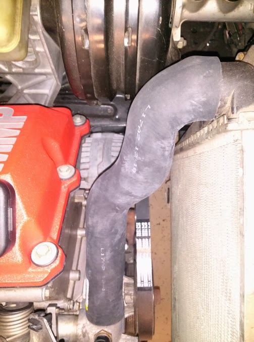

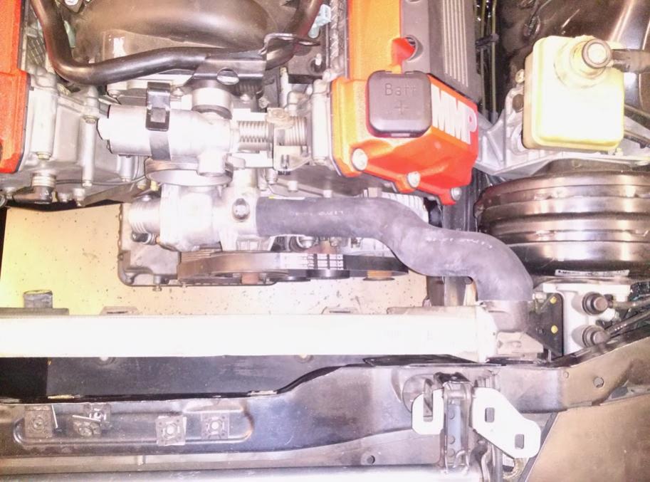

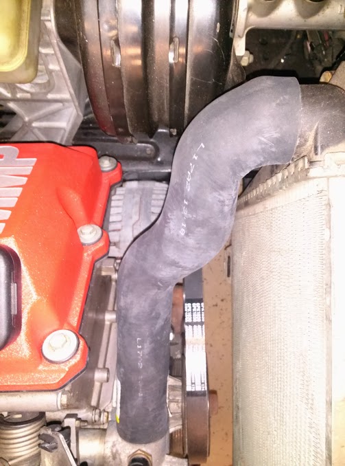

              Ok so I finally getting to the button up stage. Taking my time, trying to
              do everything right and once..
              yesterday I got the upper hose in and it fit like a glove...!
              like it was made for this setup, now just waiting on the lower coming in the mail, and a new thermo...

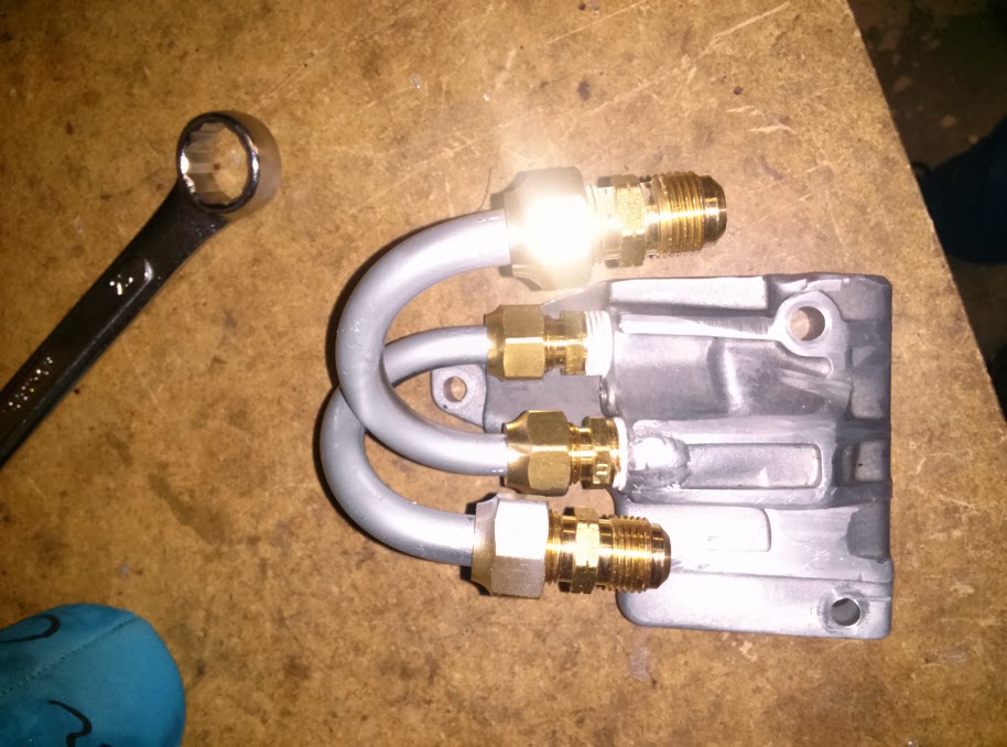

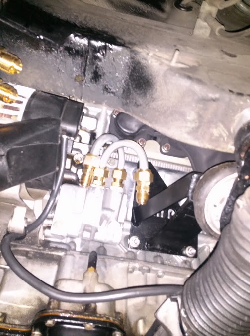

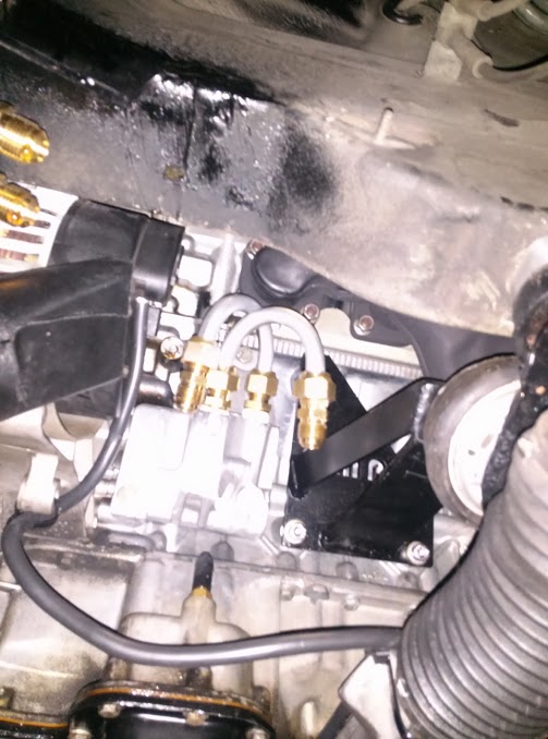

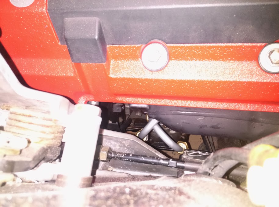

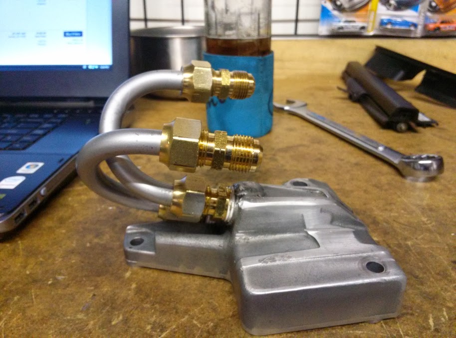

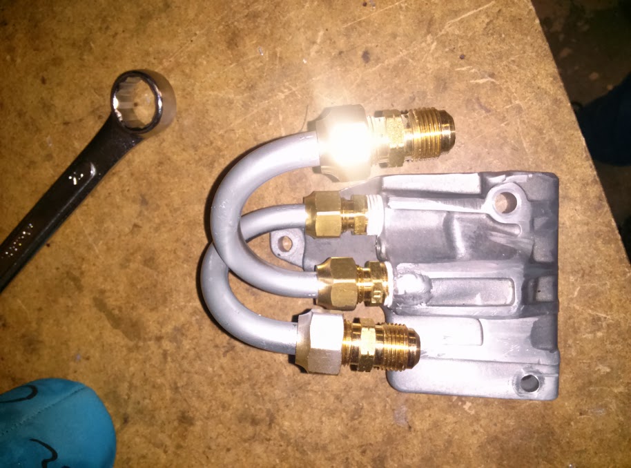

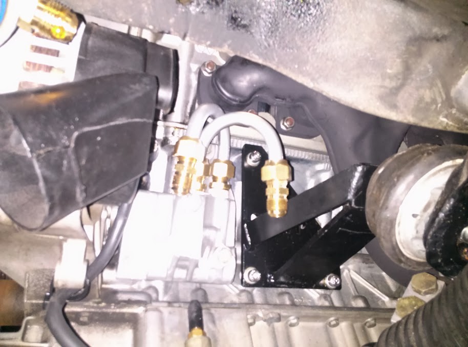

                Then I finished the oiling block/lines
                finally sorted and got a ton of clearance between then header and lines
                  [ATTACH]80453[/ATTACH]
                  [ATTACH]80454[/ATTACH]
                  [ATTACH]80455[/ATTACH]

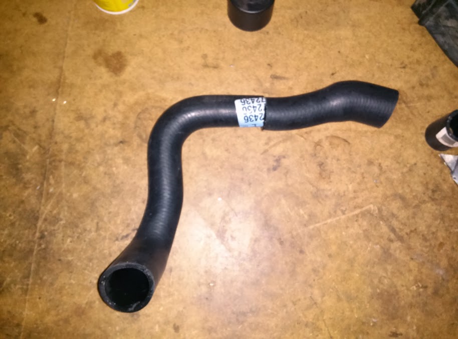

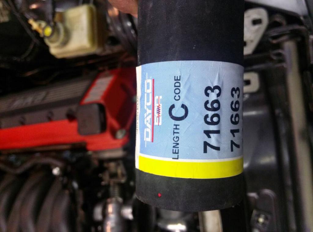

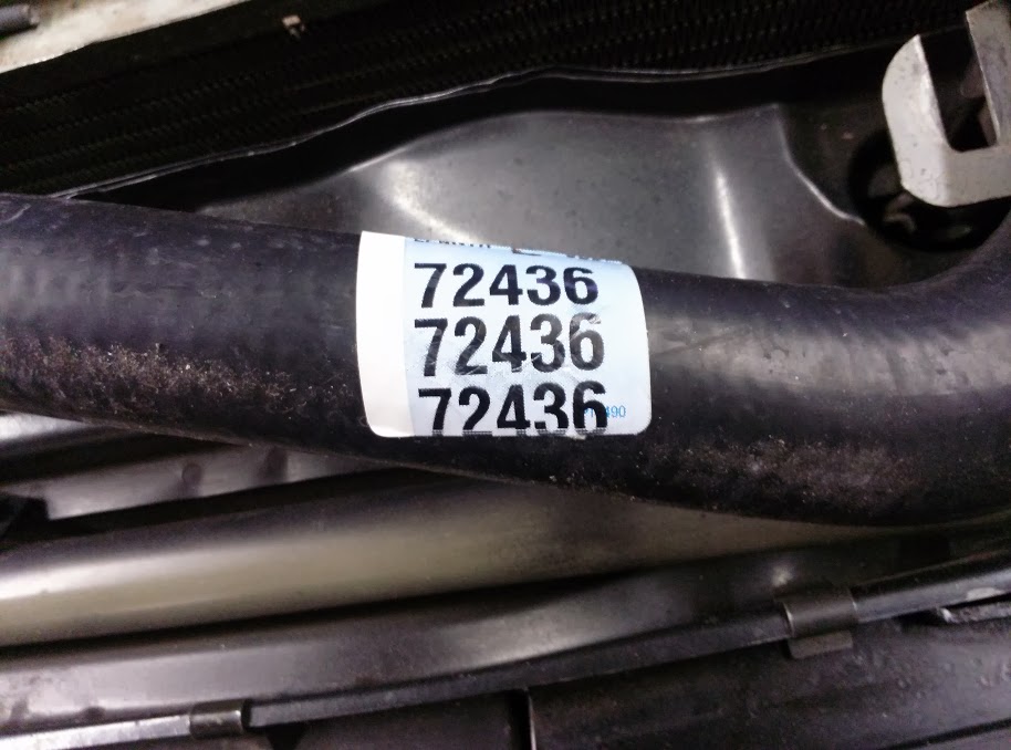

                  What application is this hose from? Looks like the PN is L17A2?
                    Its a 1995 M3 upper rad hose.

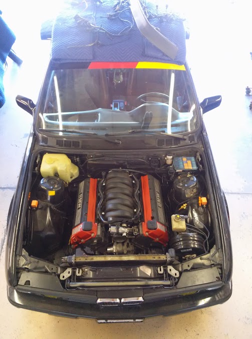

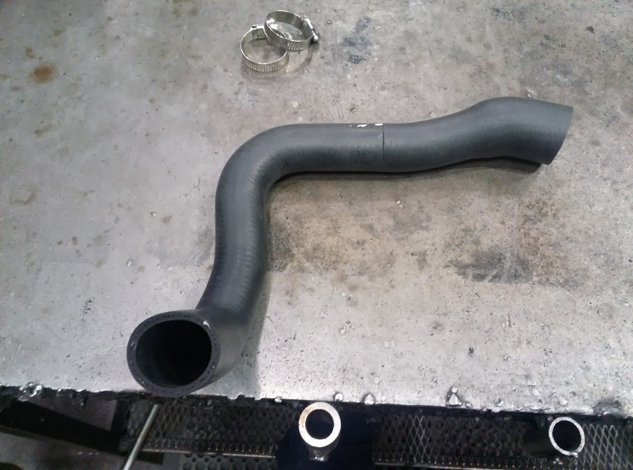

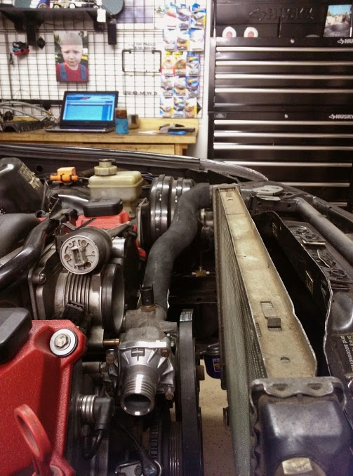

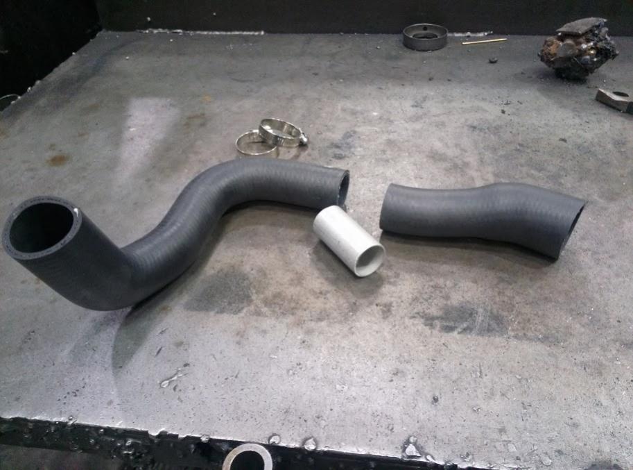

                      Ok a few more small updates..
                      First off I was able to find and purchase the remaining bit's needed to build the hybrid MP112/22 Eaton SC. More on that tomorrow when the parts show..;D

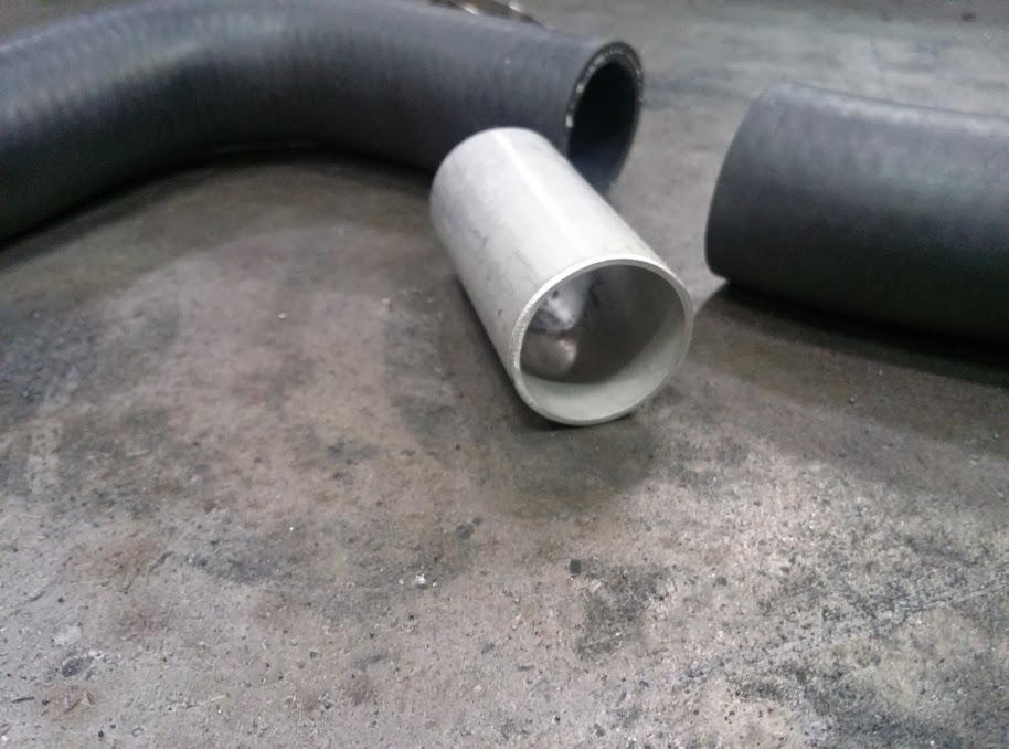

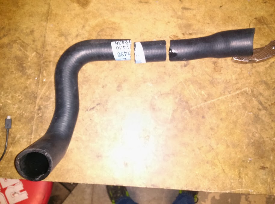

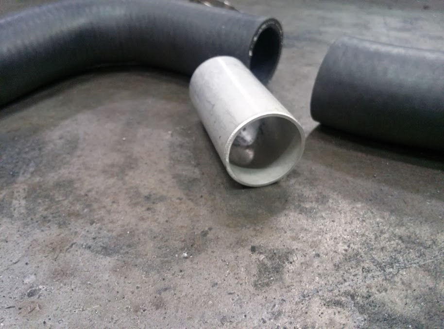

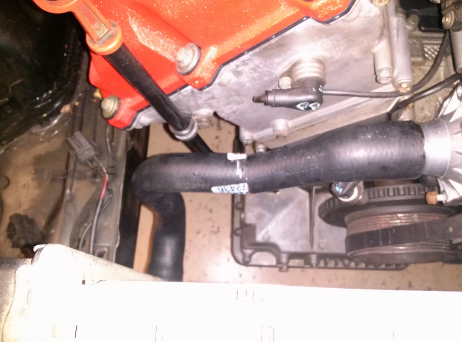

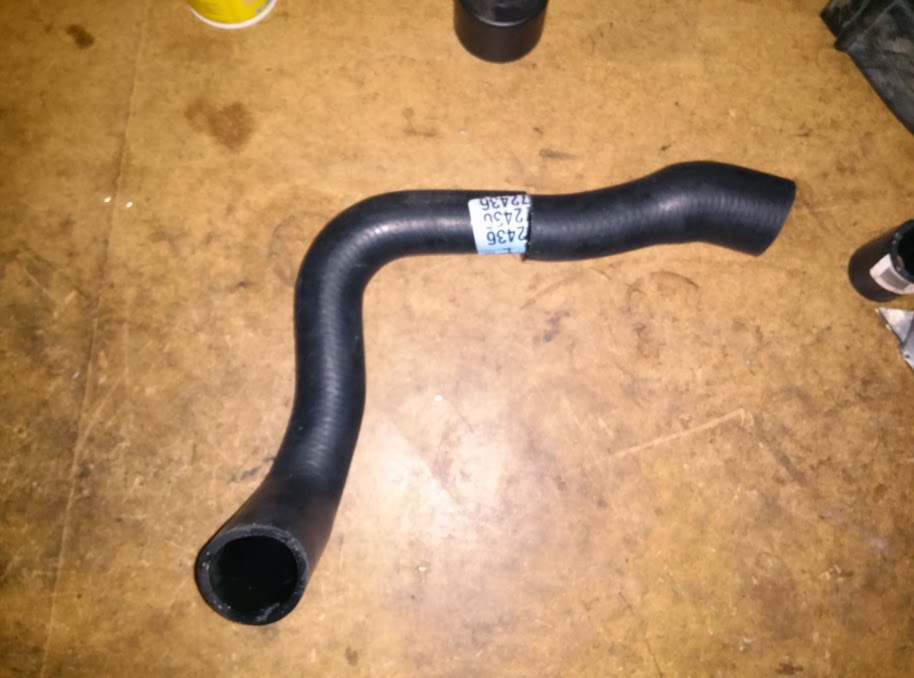

                      Today I found out that my water pump is crap. So i bought one and its on it's way. but in the mean time I was able to finish the lower hose setup.
                      I ended up using a lower hose off of the early 540i with about two inches cut out.

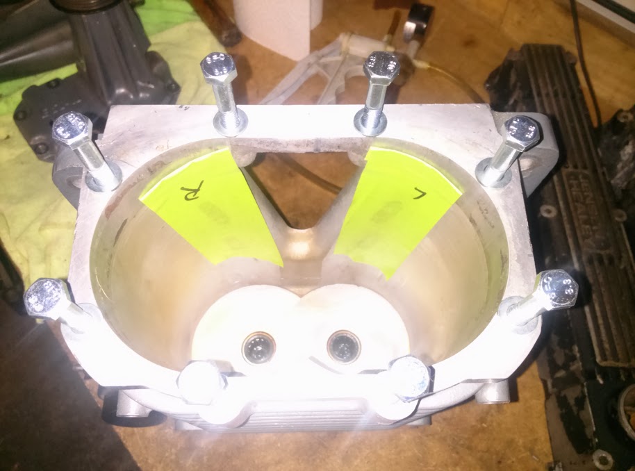

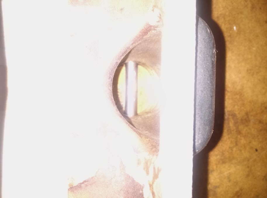

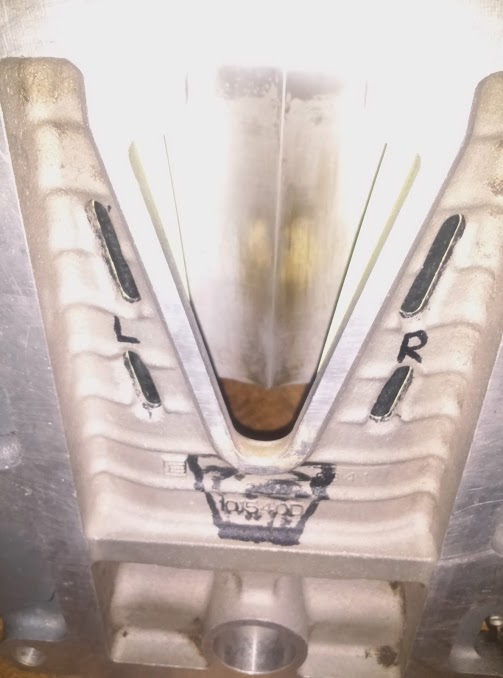

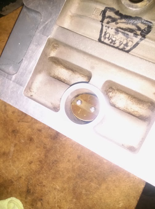

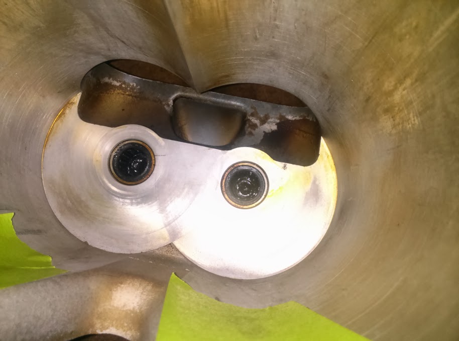

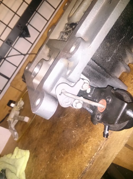

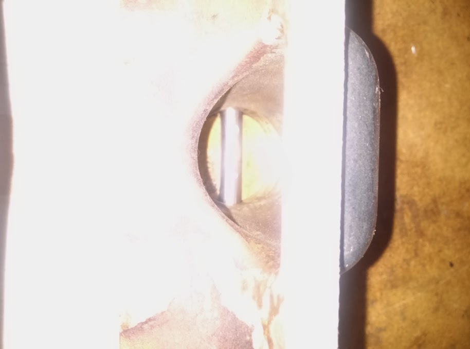

                        I also prepped the m112 housing for welding of the silencers and porting of the boost pressure passage. I have done alot of these in the past. Back when I was playing with American Iron I fell in love with the ease of moding up a motor with one of these and really waking up the motor with minimal effort. So i'm hoping i can really scare the shit of people with this car...
                        Nothing like making panties drop every time you pass an old age home! :pimp: It's tough to pull them back up while holding a walker~
