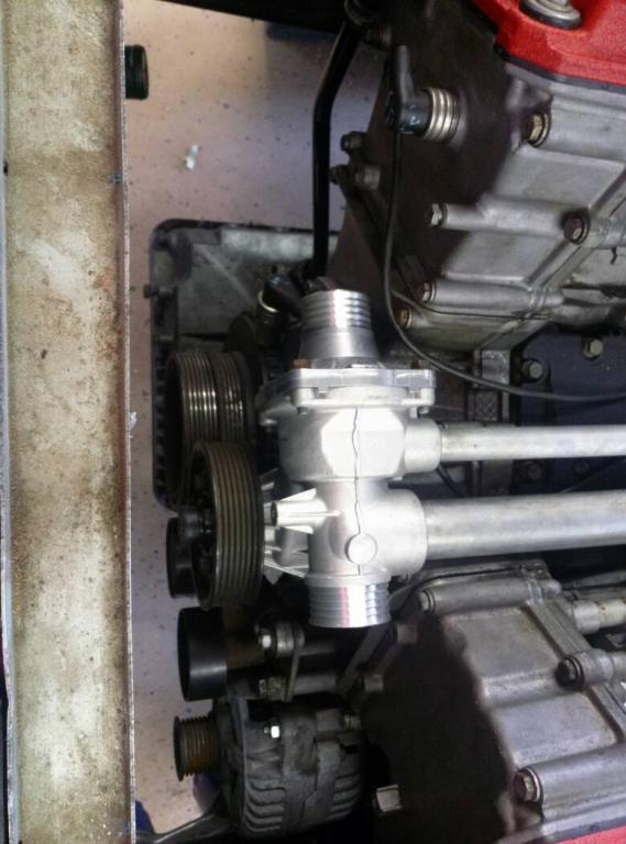

      So Got good news today my water pump came in so I'll be swapping that out tomorrow. I'll also be installing the pusher elc. fan and Rad. If everything goes right I'll also be able to install the hood... lol small victories.

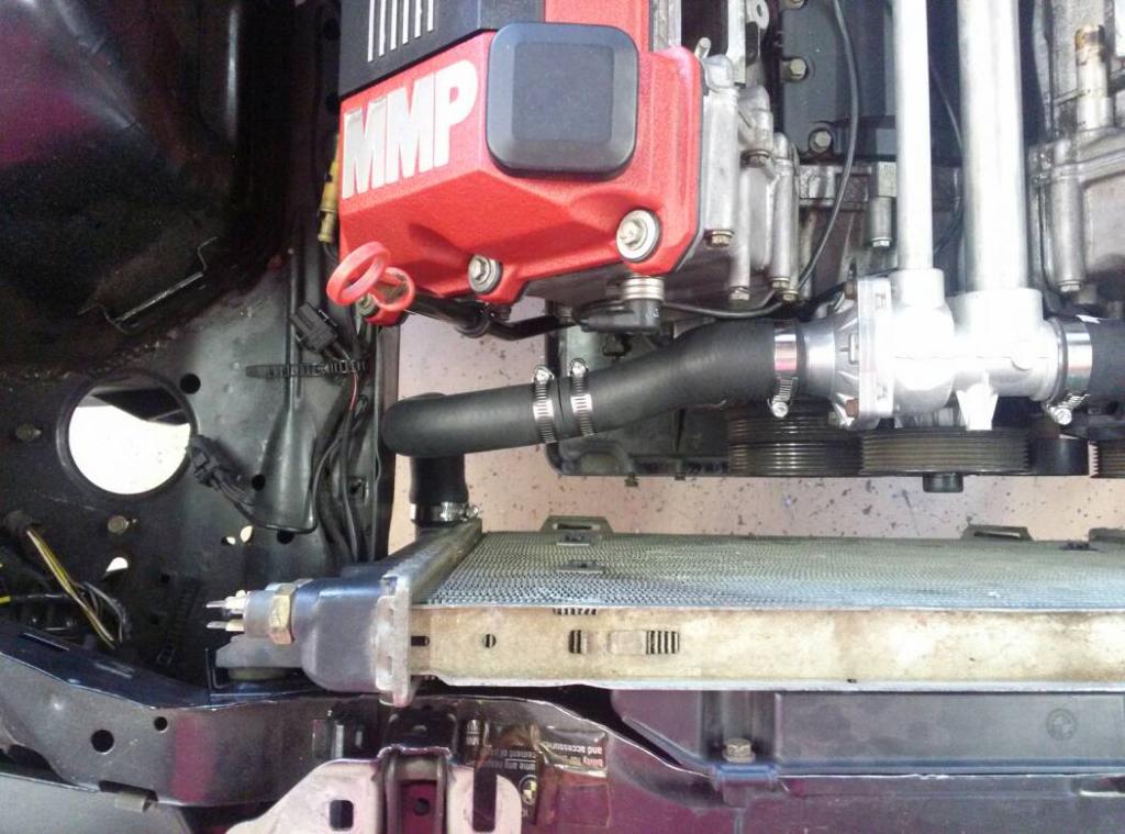

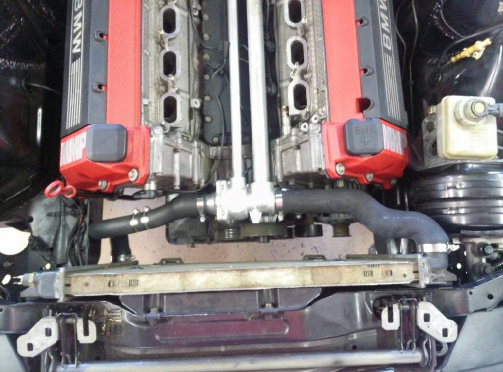

                    Ok so the old pump is out and the new pump is in. Fan and rad are mounted and all is looking good. Hoses fitted and looking good so far so good.
