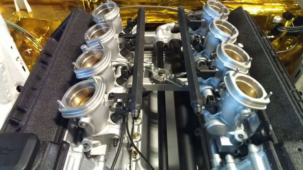

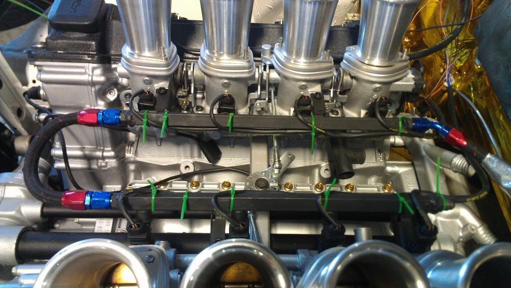

      Nopes, no pictures... but I have the linkage for the ITBs ready, waiting on a push pull cable from kinsler. And fuel rails are in

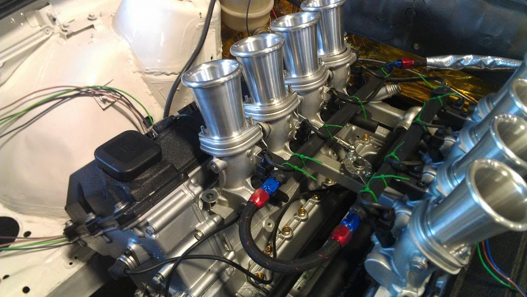

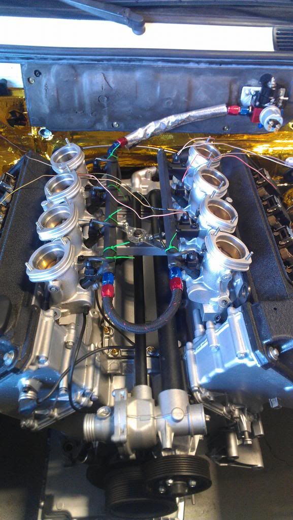

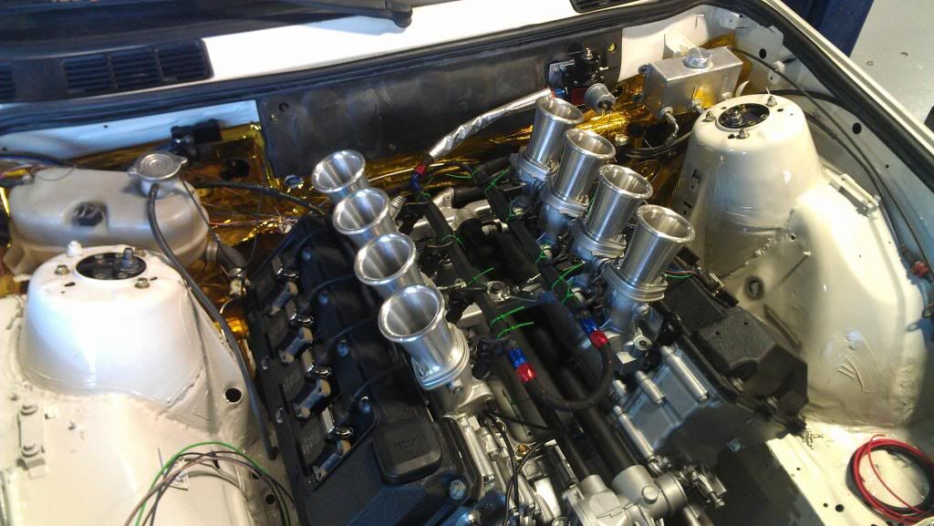

              Sooooo, I had a bit of time today and I started with the engine bay wiring.
              Ignore the green zipties, they're there only to keep the wiring in place (for now) Once I start the engine, the heat will shrink the wiring heatshrink and keep everything tidy and in place :D
              Oh, and that expansion tank is NOT gonna be there. Just wanted to give it a try, but it looks totally out of place in that engine bay right now....

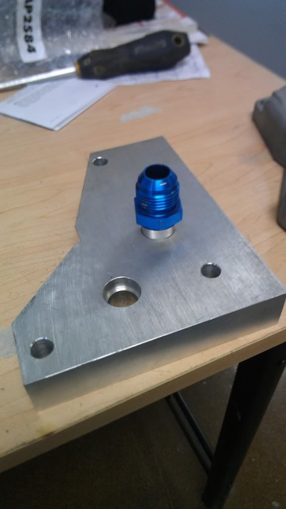

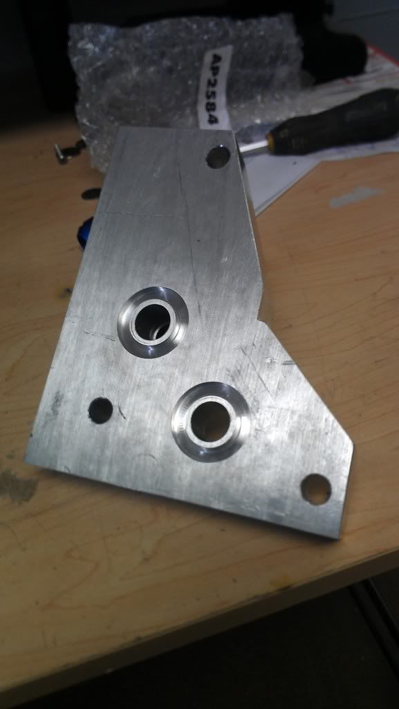

                        Well, got my oil filter plate today. It's not the most beautiful thing on earth, but will make the oil lines soooo much easier....
