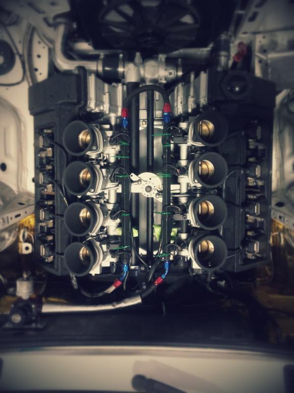

                    OK, for those asking about header-steering clearance, here's a shot. Good news is I can remove the rack without moving engine and or headers (and that is good)

                          IIRC the steering delete needs to pass fluid from one side to another. So just capping them off will cause seals to blow with pressure.

                            It does not matter if those ports recirculate or not, they can be capped off and work just fine. I put my power steering back in, the struggling in parking lots gets old after a while. The other two small hard lines are where all the action happens.

                                might not blow the rack seals, but it will make for a tougher steering wheel vs having one of those fancy recirculating blocks.
                                on a side note, i don't think it really matters since those look like those plastic temp "dust caps/bolts" that come with new racks
