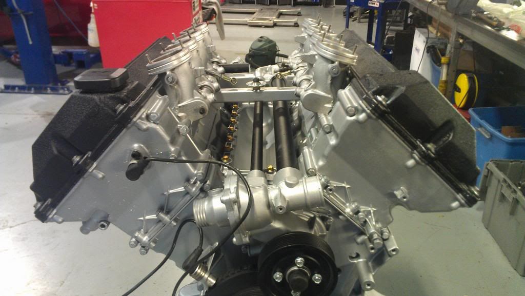

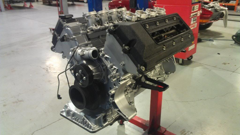

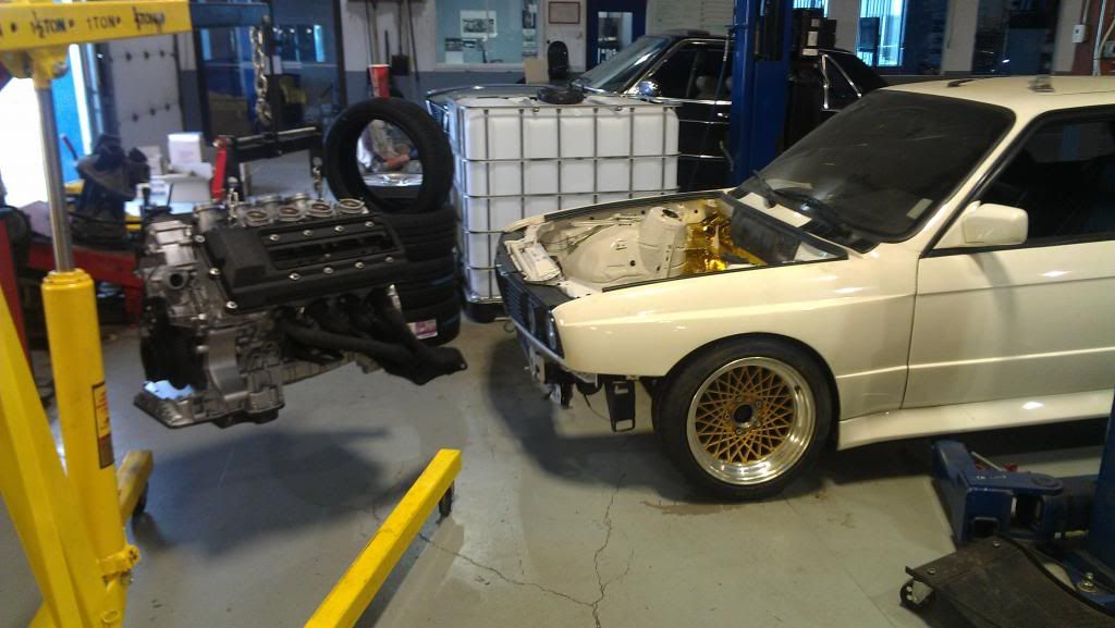

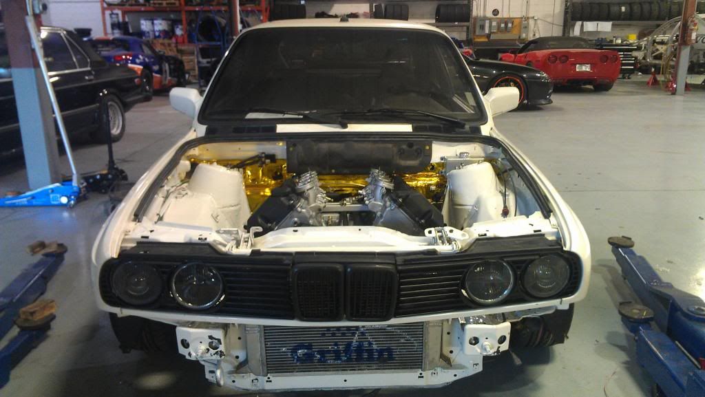

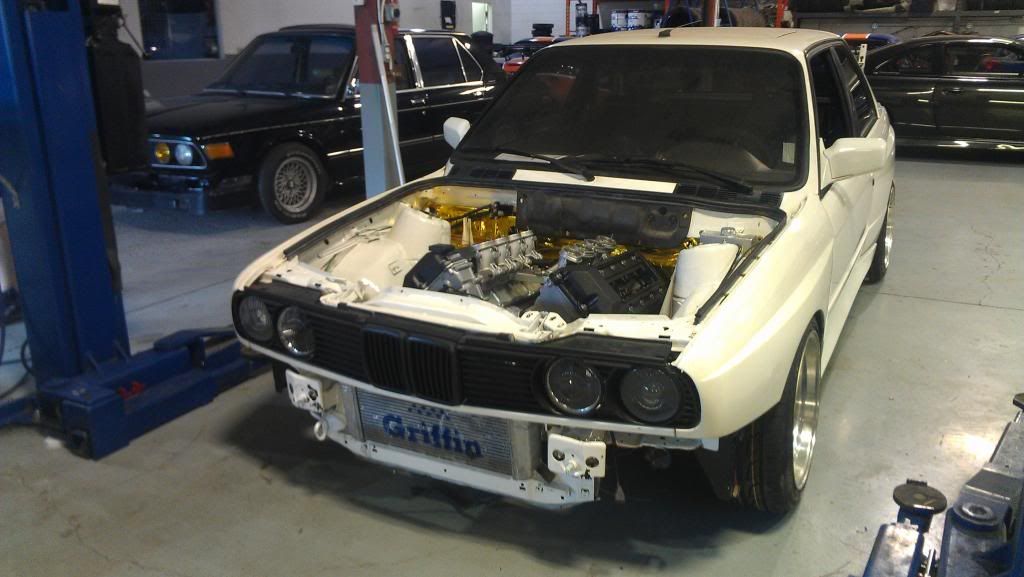

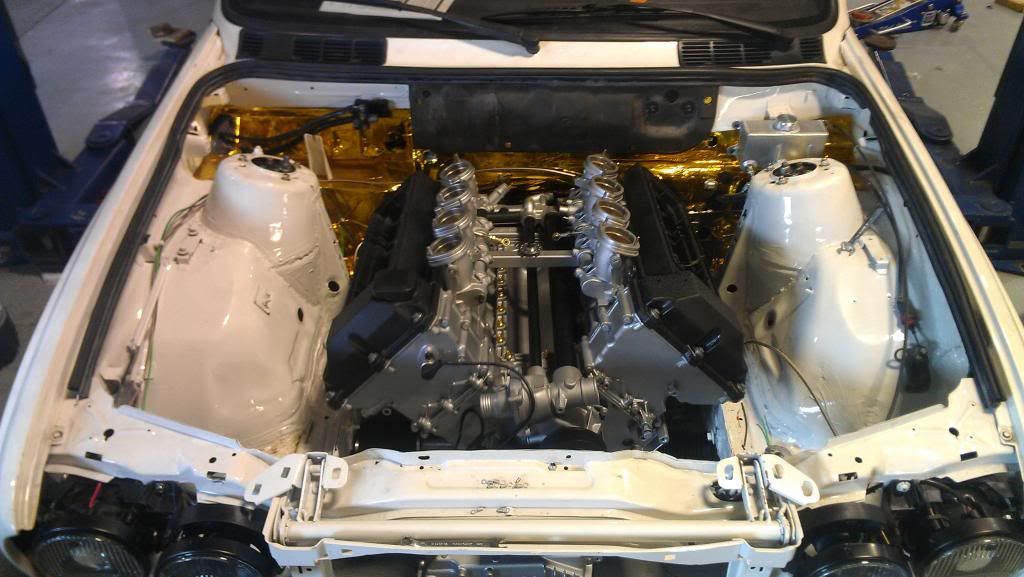

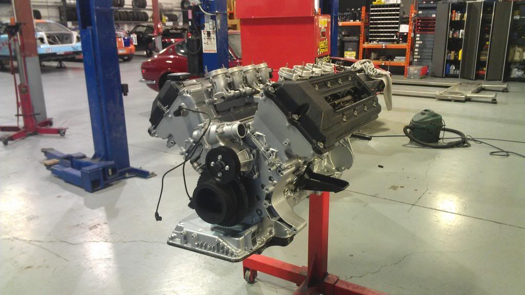

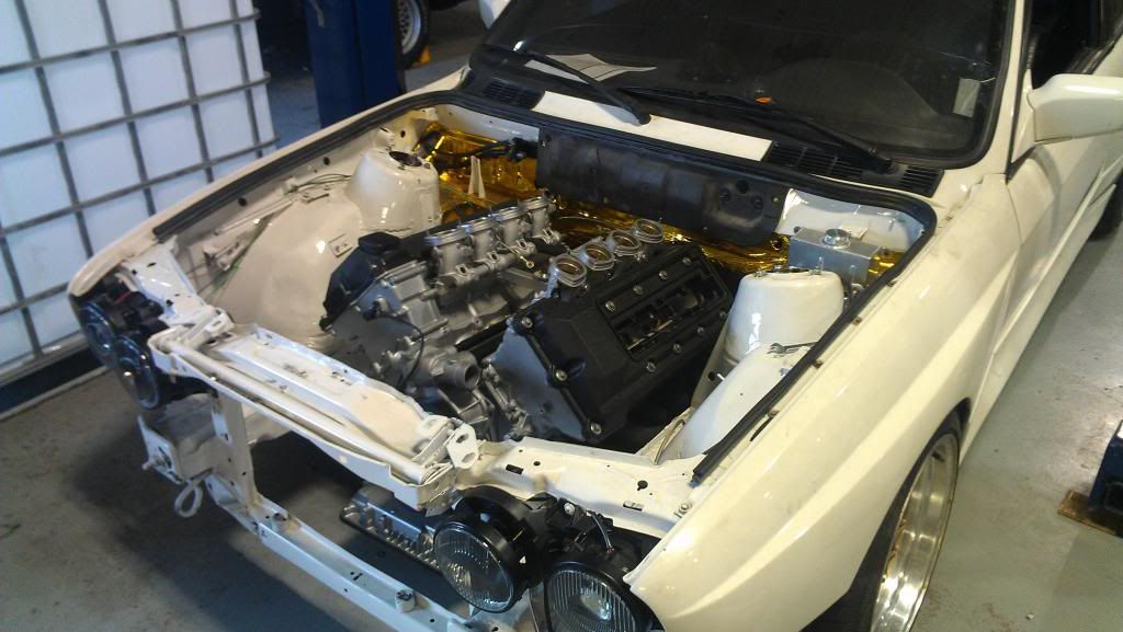

                    Updaaates!!!
                    Well, I finally got some time for me, and I managed to get some work done.
                    I put the engine back together, all new seals, gaskets etc etc etc etc
                    M5 throttle bodies bolted in place, and throttle bellcrank bolted too. I just have to fabricate a couple of arms, and good to go
                    Headers also bolted nicely
                    And finally, sitting home!!
                    And I think I'll have to raise the suspension...

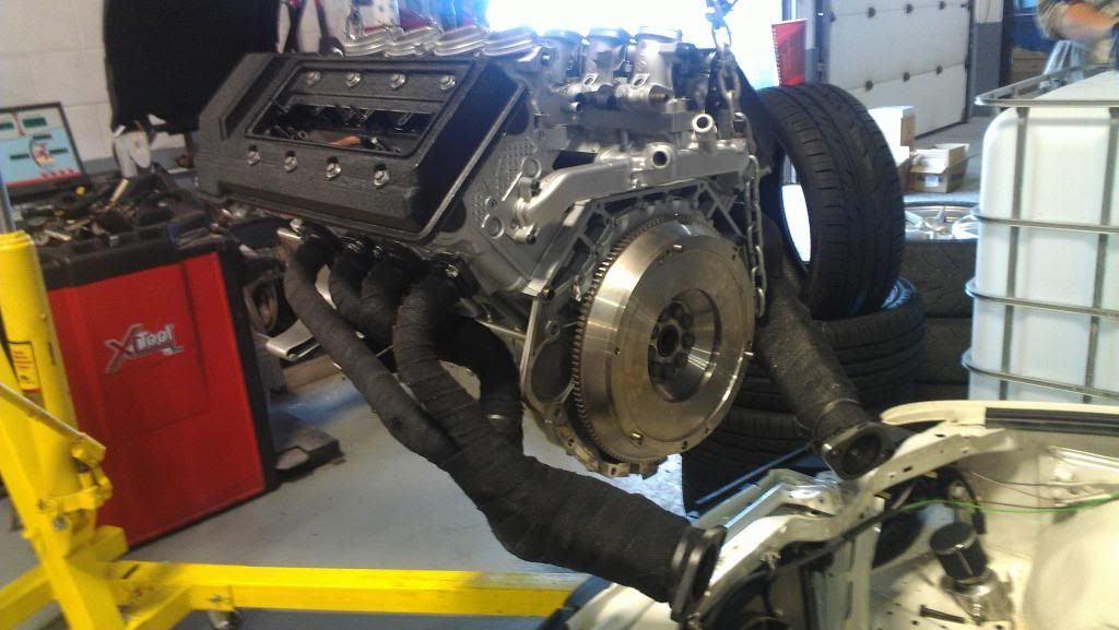

                        #86
                        I built a new set of headers. I really didn't like the 540 or 740 or any other options so... time and patience!

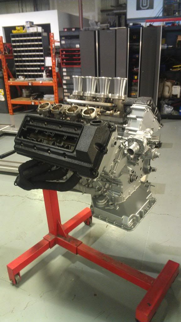

                          Dude your car/build/engine/everything is clean as fuck. Super jelly of the velocity stacks.
                          I'm surprised at how low the engine sits in the bay. Are you gonna have any room for some kind of air cleaner on top of those stacks? I imagine it's gonna be pretty close to the hood.
                            #88
                            Well, I highly doubt the stacks will fit.... I'm having another ones 3D printed, much shorter (and the finish is just like the valve covers, which is a plus), and we'll see how they fit.
                            As for the air filters... meh, overrated. I guess I'll keep those stacks for one of the S38s I got sitting here :D

                                #90
                                Do you have any pics of the headers before you wrapped them? Does the steering shaft go down in between the primaries?
