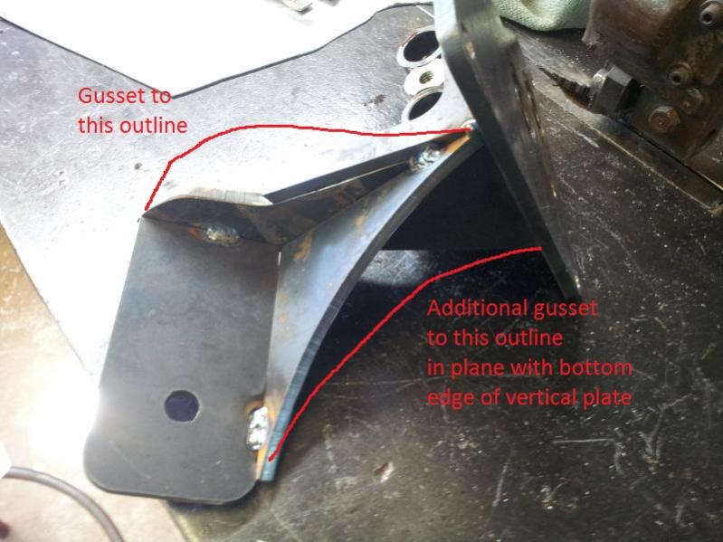

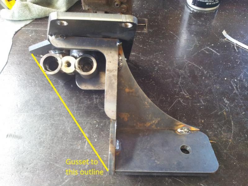

    Originally posted by mattdk318i

          From your wording, it came across that you were concerned about the bolt loading rather than the bracket gusseting.
          After all, the stock mount arms load the bolt joints mostly in tension/compression while the one you have load them in shear. I don't think that will be a problem for the joint from the bracket to the block... I was just noting that the bracket itself may need additional gusseting to deal with the load (over time... fatigue due to dynamic loads being much higher than static loads).

              Here's my take:
              The torsional stiffness of the structure is related to the radius of gyration of the smallest section, which in this part is right at the "wrist" at the base of the plate that bolts to the rubber mount. Increasing the minimal dimensions of that section should be the priority for bracing.
              Although if you eliminated the flat plates altogether and use round tubing instead, that would probably be better, as a cylinder is the stiffest shape going (external dimension = radius of gyration by definition)

                    Heres some revised mounts, going to weld them up some time this weekend. And i got my 1940's grob bandsaw to the AC bracket/Engine mount. Now its just a AC bracket
                    Before its untimely demise, My german made Ruhla(mill) looked on in horror im sure.
                    Some finished pictures of the mounts. Whipped out some more bungs. Going to try a simpler approach this time. Ill be working on that some more in my head lol
