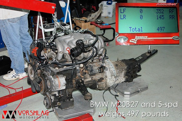

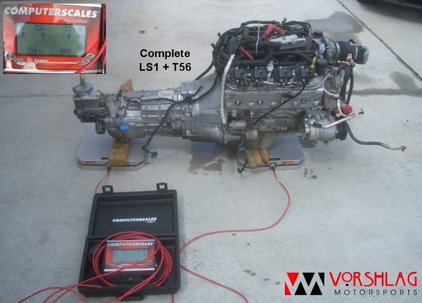

            • varg
              Florida Turbo Man
              • May 2014
              • 3431
              IG @turbovarg
              '91 318is, M20 turbo
              • ForcedFirebird
                • Feb 2007
                • 8300
                ^^^was wondering what the differences would be total package since I have picked up t56's and they are far from light. Been a while since I shipped a g260 and didn't record the weight anywhere. Didn't bother searching the internet when posting, knew the general weights from memory, good find Varg - forgot Vorshlag weighed everything back then.

                • The Dark Side of Will
                  • Jun 2010
                  • 2796
                  A T56 is around 120 lbs, a G260 is in the 65-70 range.
                  • varg
                    Florida Turbo Man
                    • May 2014
                    • 3431
                    Vorschlag is doing God's work by weighing car parts and posting pictures of it. Good engine and transmission weight information is nearly impossible to find. The above is a Getrag 250 not a 260, so we can assume the 260 is a bit heavier than 70lbs since it is physically larger and stronger.
