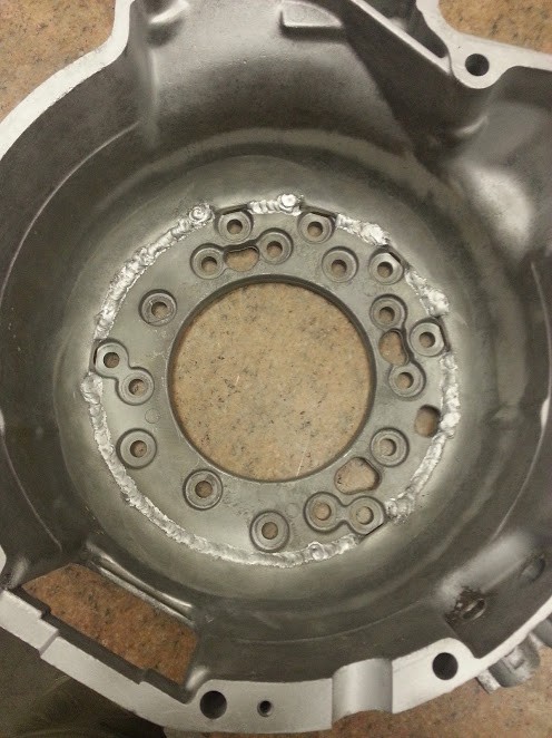

        It seems that somebody cut out the center of the bellhousing with holes and welded in a new center with different hole positions.

          the vehicle is a land rover with an existing 4HP22H and transfer case. the swap has been done with an M70 but that has a direct fit bellhousing/pump combo.
          the cutting and welding in that was done to counter the m20’s offset and allow an S52 to bolt into the 4hp22 non-crooked. they have the same bellhousing pattern
