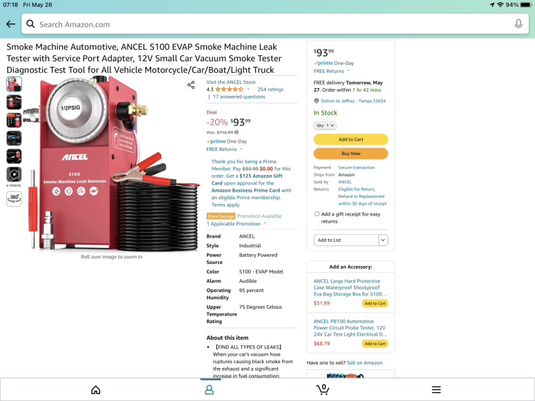

              I bought this one off of Amazon and it does exactly what it should. It has a built in regulator and no flow guage but it does have a valve so you can control smoke volume. I don't see why you'd need anything more Click image for larger version
