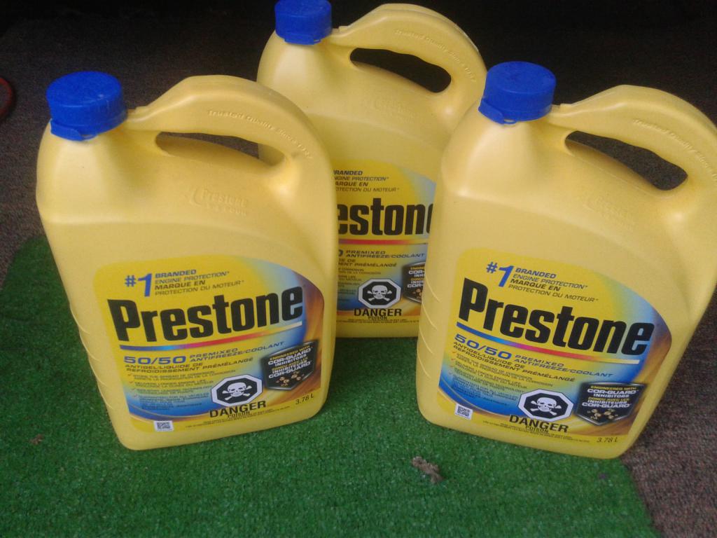

            green coolant that should be blue
            bkuz we donut kare.
            I use green in everything.
            Bkuz they come to me that way,
            and seem to survive just fine.
            For dekadez.

              How many independent shop carry blue coolant? The answer is almost none.

                  All I can say on the subject of coolant is that the M42 makes its rear coolant outlet disappear with green, and I have yet to experience this with blue.

                    What is most important than the color is that it has coolant in it and that it doesn't leak out.
                    Both of which i think have been compromised on OPs vehicle.
                    • dnguyen1963
                      • Nov 2011
                      • 2649
                      High quality coolant that was specifically designed for aluminum engine should work fine for E30, regardless of its color. Color does nothing for engine cooling or protecting.
