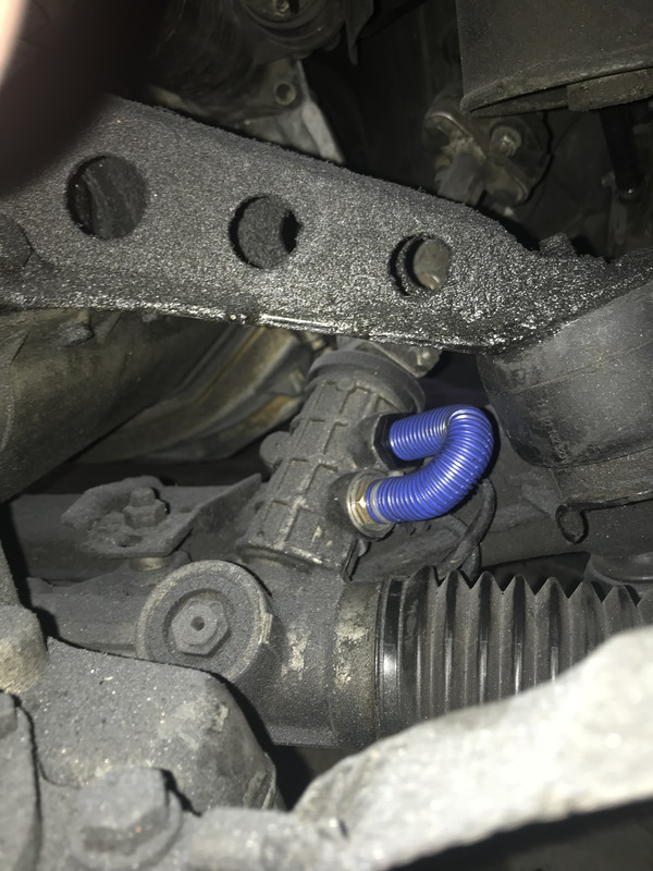

                            Thanks for all the responses. Here’s what I ended up doing. Using barb fittings and a hose, I connected the two holes. Came out less than 15 bucks total. Remember, I didn’t have the banjo bolts so this is still cheaper than buying both banjo bolts and the delete kit.
