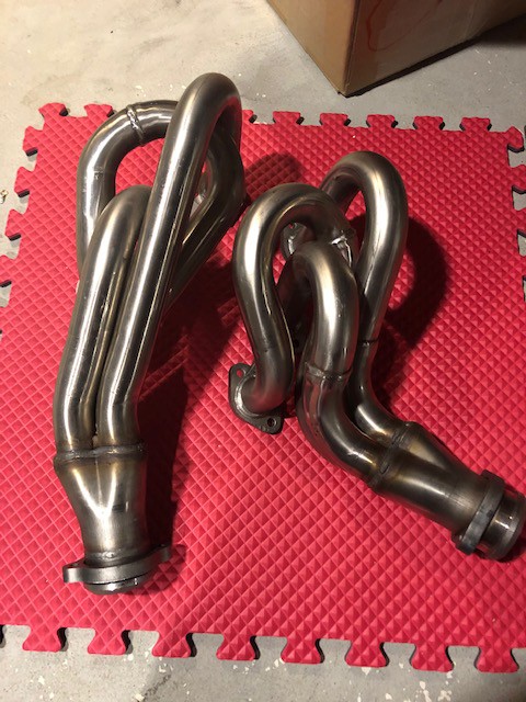

    I purchased new headers from Ireland Engineering. https://www.iemotorsport.com/product...g-headers-m20/
    Description clearly states the following: #1".....fabricated from 304 stainless steel using GTAW weld process and back-purged" and #2 "They come with stainless steel V-band clamps and additional weld on flanges. You will need to fabricate your own down-pipes."
    #2 above: V band clamps or flanges were not included in the package, the reason why is still unknown
    #1 above is being the major issue. I used my borescope to inspect those welds internally and found that they weren't back purged properly during welding, visible sugaring and weld penetration issues. Furthermore, some sections in the circumference of the joint are totally missing weld penetration.
    Please refer to attached pictures and make your own concussions. If you aren't sure about back purging and how the weld should look internally, this video is a good example and shows the difference clearly https://www.youtube.com/watch?v=F2T1diKBcYI
    Click image for larger version  Name:	image0.jpeg Views:	4 Size:	62.1 KB ID:	9920808 Click image for larger version  Name:	image1-7.jpeg Views:	4 Size:	61.2 KB ID:	9920809 Click image for larger version  Name:	image3-2.jpeg Views:	4 Size:	54.2 KB ID:	9920810 Click image for larger version  Name:	image2-5.jpeg Views:	4 Size:	60.5 KB ID:	9920811 Click image for larger version  Name:	image4.jpeg Views:	4 Size:	46.4 KB ID:	9920812

          Just to compare to Federico's Racing Dynamic headers:
          ugly welds but robust construction, (tubing almost twice as thick as IE reproduction), 409 stainless (which can rust unless coated). All weld joints ale overlapped
          Click image for larger version  Name:	image0-1.jpeg Views:	0 Size:	55.2 KB ID:	9920843 Click image for larger version  Name:	image1-8.jpeg Views:	0 Size:	106.2 KB ID:	9920844

                      That's why I got them, welds looked ok in the pic. Knowing the importance of back purging the stainless tubing, I decided to inspect those welds from the inside.....after all IE does use word "back purged welds" in the item description....Well not only those welds don't look back purged, they don't look like welds are fully penetrate those joints.
                      Look at this video .....you can fast forward to 15:20 if you don't have time. This video is a good example what properly penetrated and back purged welds should look like
