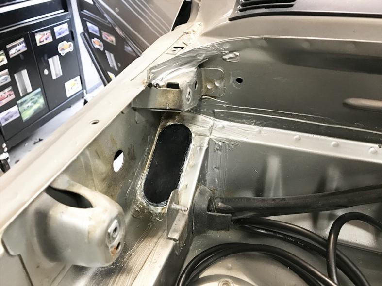

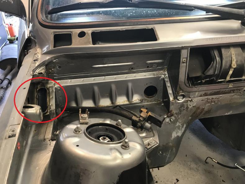

    Finally got around to removing the A/C hoses running through the firewall.
    Any suggestions on how I can block this hole into the cabin? I took a quick look at RealOEM and didn't see anything that fits.
    Cheers!

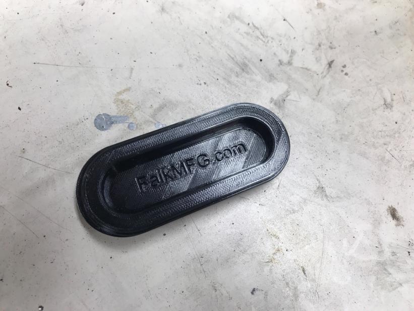

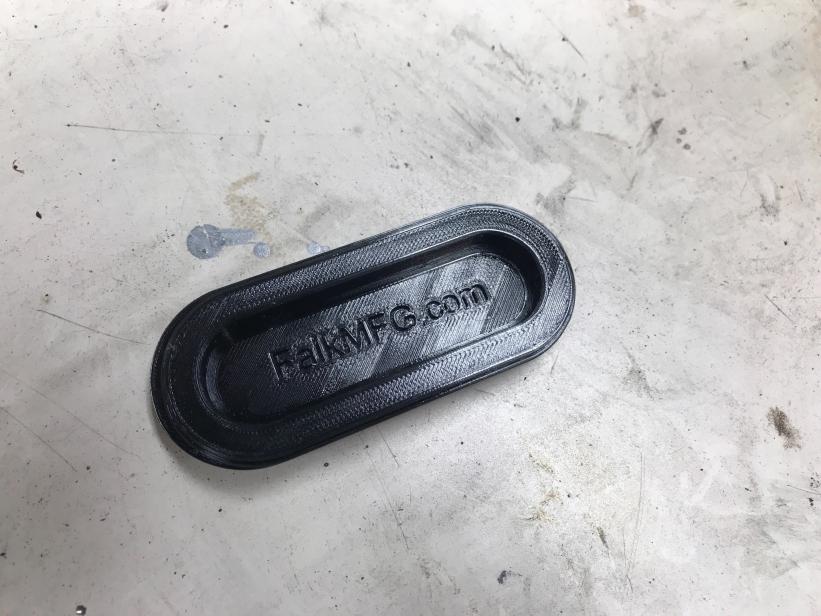

        I have to thank Jacob Falk from the R3V facebook group.
        He saw my post and designed and printed a plug for me, in record time!
        I love our enthusiast community!
        I used some sealant for good measure when I installed, but i'd say it would keep the water out without it.
        Fit is fantastic, and it's fully reversible if I want to run A/C again. Reasonable price as well.
        It's also a soft/pliable rubber material, could drill a hole through it and run wires if needed.
        https://www.falkmfg.com/ is his website if you need one!

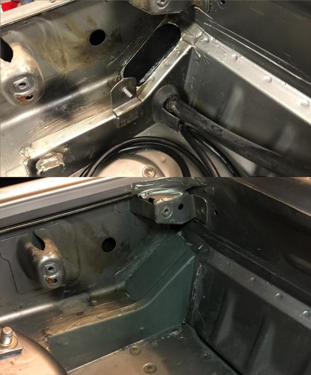

          Thread update:
          I ended up welding in a patch for the hole.
          The plug worked great, I just wanted a cleaner solution for my semi-shaved engine bay.
          Click image for larger version  Name:	51003652408_d6909b8fb0_b.jpg Views:	377 Size:	63.1 KB ID:	10036990
