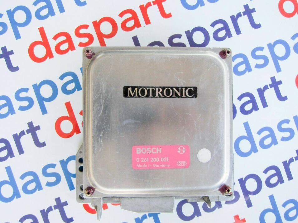

            Has anyone with a 1984 BMW 325e replaced the chip with a performance chip even though the chip is soldered in from the factory. My Motronic 0 261 200 021 has a soldered chip. Thank you.

              Not worth it if soldered in place. Pretty sure you can replace it with an EPROM equipped model, but you should double check that.

                • ForcedFirebird
                  • Feb 2007
                  • 8300
                  ^^ if you, get the ***027 green label ECU. I have a stack of them if you dont fond anything local.

                    Can a 021 be replaced with a 027?
                    • reelizmpro
                      • 9558
                      Yes, swap to the 027 if you can. You may even be able to get one with a performance chip already inside.

                          You can unsolder the chip using a solder sucker.

                              But why would you?
