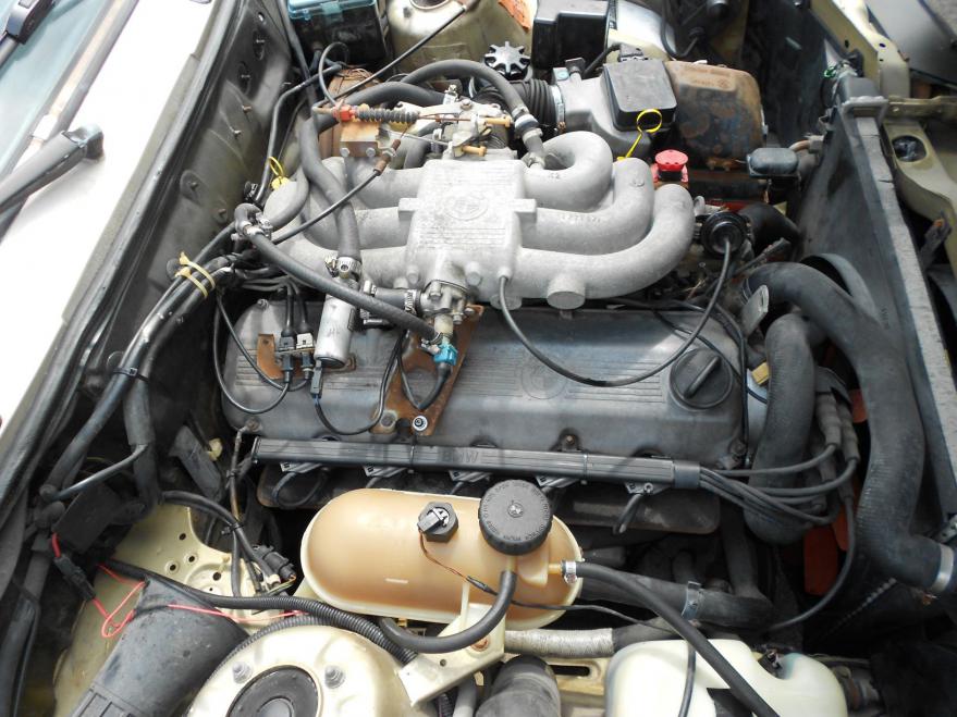

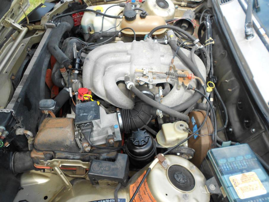

                      This is strange because chips make a huge difference on Eta cars. We're talking 24-27HP at the flywheel and better overall driveability even with the auto trans. Are you sure it's a genuine chip and you are running premium octane fuel? Perhaps something is going on with your car. Post a pic of your engine so we can be sure of what you have.

                        2.7 Liter engine.
                        • NYCDelphin
                          • Aug 2016
                          • 223
                          is that a factory alarm?
                          • 84mint325e
                            • Feb 2020
                            • 56
                            I don't know but I removed it a year ago.
