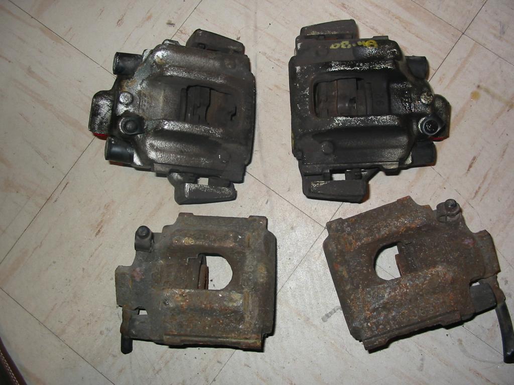

    Whatever is that on the bottom, do NOT use.
    ... yes, you can use e36 325, 318ti, and z3 calipers...
    Leave a comment:
  • bimmer630
    replied
    aptyp..., You wrote above that ANY rear caliper from an E36 will work, right? and you said when doing so you simply flip them side to side to get the lines to be in the right places? Is that only when using non-Ti parts?
    I have rear calipers and brackets from an E36 Ti and also a set from an E36 325. they look very similar in all aspects except the position of the bleeder screws.
    The Ti calipers have the bleeder screw pointed in the same direction as the line inlet, and the 325 calipers have the bleeders pointed opposite the lines.
