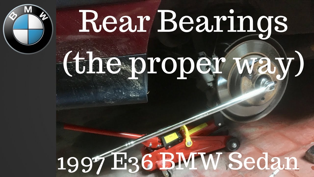

      If these guys can do it using bits of pipe, i'm sure a shop can do it with proper tools.
      • Zambuzan
        • Nov 2017
        • 434
        Originally posted by e30davie
        https://www.youtube.com/watch?v=a4L9Id_gIhs
        What would be the proper tools to tackle such a bear of a job? Some huge ball-joint-like C-clamp thingy ma bobber?

          FCP Euro carries a tool set for the bearings, listed under the wheel bearings section . . . $465!! I can see why the guys on that youtube DIY made their own from generic home depot supplies, Having said that, I definitely don't have the time to go shopping at home depot for supplies to build my own tools, and I am not sure PVC is safe for that application if the bearing is seized into the hub . . .

              I would just copy what they did. But with steel pipe.

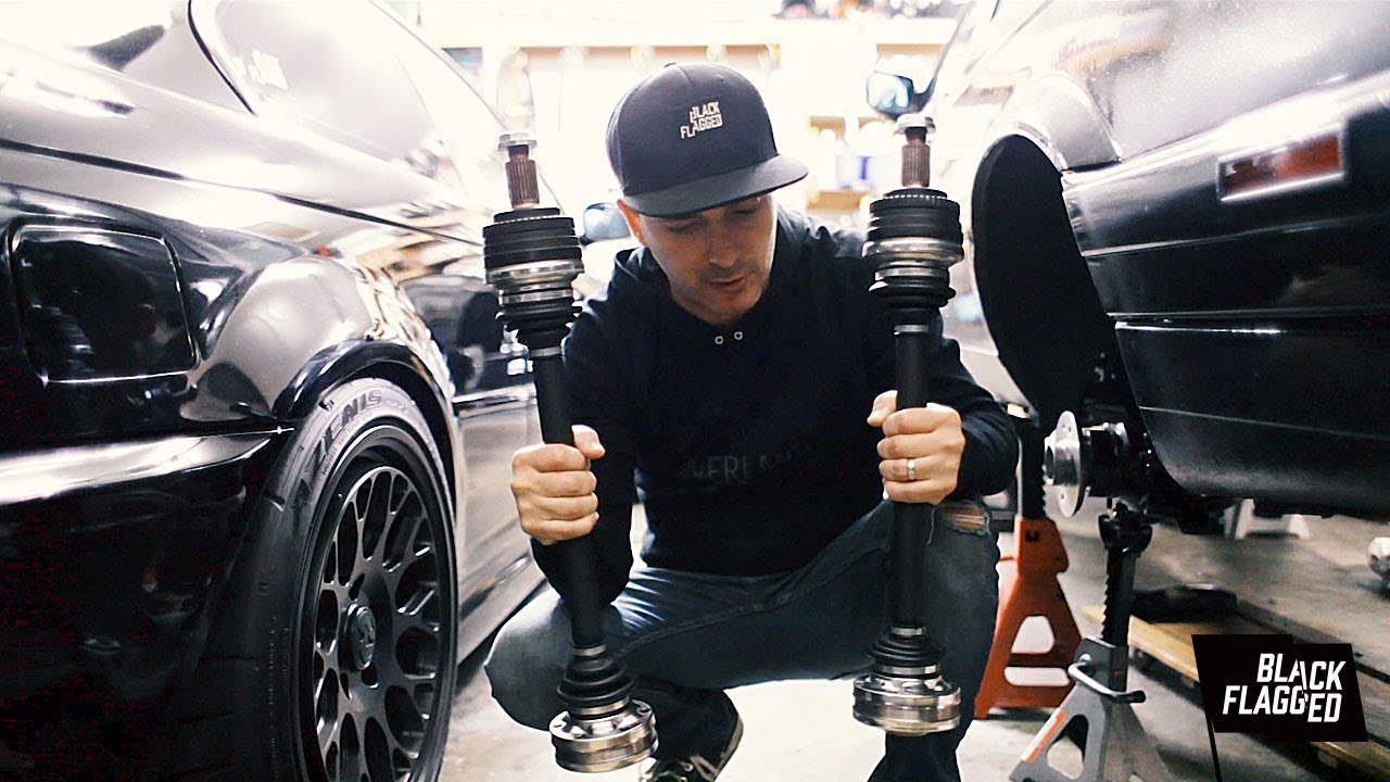

                    You can rent a special tool at Pepboys.
                    • Part#: 27192
                    This guy shows how to use it.
                    But he inserted the securing plate incorrectly. It should be hammered in after the nut is torqued.

                        Tap around the circumference of the axle with a hammer and piece of wood. When I installed new axles, I had to clean the splines with a V file and use an axle puller tool (just like one of the ones pictured above) that pulls the axle in from the hub side after you get it started. This tool was only $15 on ebay and makes things much easier.

                          I wouldn't recommend pressing them in using the tool, only removal. I just serviced the axles in the race car after 5 seasons, and they slid right out and back in by hand - the way it's supposed to be.
