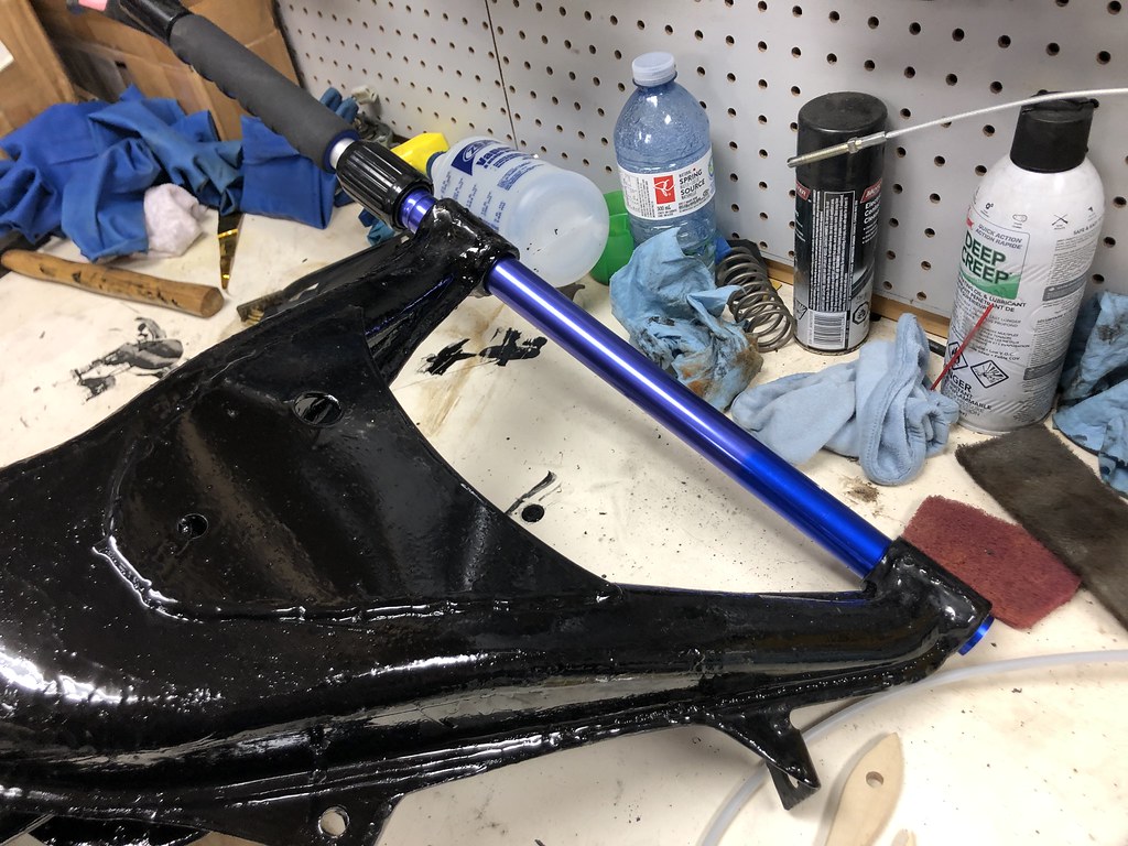

                Originally posted by Shifty_K
                The bores should line up right?
                Old thread, but yes.
                My blue snow brush handle happened to be the exact right diameter with no slop.
                Both my trailing arms lined up perfectly. I was checking after welding in reinforcements after the suggestion by econti in my build thread.
                POR15 on mine not powdercoat just FYI.
