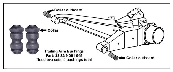

    In the process of doing a rear subframe refresh. I’m putting everything back together and my right rear trailing arm is not fitting back into the subframe. Everything came apart fine and I did not modify it - only sent it off to be blasted and coated. I’m running Garagistic poly bushings. What’s going on here? Is something bent or twisted?

    You sure you have the bushings in the right way around?

      Pretty sure. Fat part on the outside, right? Other side fit fine.

        Looks like you have it right.

        Looking at it more closely, it doesn't look like that difference would fix your problem anyway. Maybe measure it against the other one? That's really strange, and I can't imagine how it could bend that much just from blasting it.

                      Looking at that picture, have you tried dropping the arm in from the top versus in from the rear? Those tabs appear to be on a bit of an angle (pictures are tough to judge) and coming in from the top MAY make a difference.

                        I did try that, yes. No luck.
                        Looking at it, it seems that if I reversed the bushings it may fit. Anyone know if this would have any major consequences as far as alignment is concerned?

                              I reinstalled both bushings with the thick collar on the inside and can get it installed but the last bolt holes are still off about 1/8th of inch, seems like it might go if I reposition the subframe and arm so I can maneuver better.
