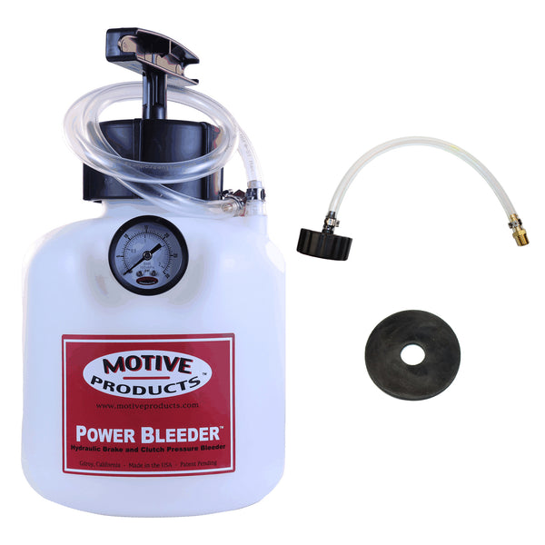

      yes, you should flush and bleed the brakes periodically or have it done by a shop.
      Get yourself a motive pressure bleeder (or similar) with the BMW reservoir adaptor, a bunch of dot4 fluid and DIY. or the cheapest way is to get a friend who works for free to work the pedal and you bleed with a bottle and hose starting from further caliper from M/C and working to the closest. Its pretty straightforward only gets complicated sometimes if you are changing the M/C

              Which model did you get? I’ve been looking to get one because gravity bleeding isn’t cutting it.
              • digger
                • Nov 2005
                • 6097
                Bleed European car brakes solo with the Motive 0100 Power Bleeder: 2 qt tank, 45 mm ATE-style adapter, fits BMW, Audi, Mercedes, Porsche, VW, Volvo.
                https://www.bimmerworld.com/Tools/BMW-Brake-Tools/Motive-Brake-Pressure-Bleeder-BMW.html#:~:text=The%20Motive%20European%20Brake%2 0Pressure,ve%20seen%20on%20the%20market.
                • reelizmpro
                  • 9529
                  That Motive pressure bleeder is the way to go because it keeps the reservoir filled automatically. I haven't had much luck with the vacuum method. It takes forever to bleed all 4 properly. On top of that you have to stop and make sure the reservoir stays filled.
