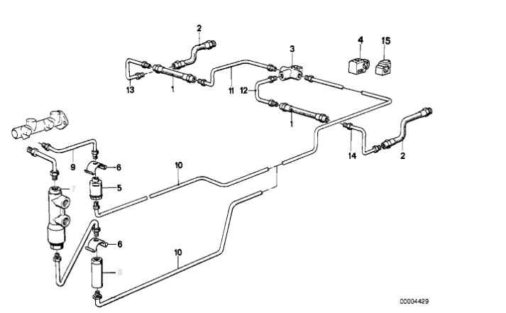

    Getting ready to replace the brake lines around the distribution T in the rear under the gas tank..Does anyone sell pre bent hard lines anymore?
