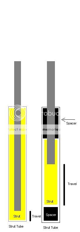

                #97
                Originally posted by Mucci
                Yea, but you asked if you had to cut your tubes.
                Getting more shock travel at the same ride height means lowering the spring perches, which means cutting the tubes, which forces you to have to run shorter shocks.
                Otherwise they're pointless.
                Why? If i run 2 spacers wouldnt it accomplish the same thing? One at the bottom of the tube would be the length of whatever the tube would normally be cut and the other normal spacer that everyone talks about. Hence this:
                -Alex

                  #98
                  I'm not really sure what you're talking about. 2 spacers? I understand the bottom spacer but where's the other spacer go? From that picture it looks like it gos on top?? That doesn't make sense. There's a collar nut that screws down the top of the shock casing in the tube.
                  I don't see how you could stay at the same height and get more shock travel without modifying either the spring perches or the shock towers (which shouldn't be an option). The space between those two contact points wont change unless you run a different spring - which means you won't be at the same height.
                  Maybe I'm missing something here?

                    #99
                    no you are right
                    running a shorter insert in the same length housing does not increase suspension travel. You will bottom out the same place you would with stock length inserts. and on top of that you have less droop.

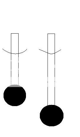

                      #100
                      So this is how i see it... maybe im wrong and someone can point me in the right direction.
                      Wouldn't cutting my housing lower my car? My springs are going to compress to the same height no matter how short the housing is. So i would end up with this effect?!?
                      Sorry for the MS paint stuff but its faster then explaining :)
                      -Alex
                      • nando
                        • 34844
                        #101
                        well you wouldn't normally cut the housings unless you were using coilovers. So no, it wouldn't affect your height, because you would adjust the perches and choose the right spring length to end up where you wanted to be originally.
                        so if you were using 5" length, 500# springs in the front, and you shortened the housings 3", you would need 8" length, 500# springs instead.
                        unless you just want to be lower. ;)

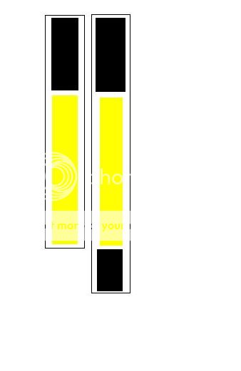

                              • Uber E30
                                • 1409
                                #105
                                You need to increase the distance between the spring perch and the shock tower
                                Why? Isnt the piston in the shock just hitting the end of its travel because its so compressed? If so then using shorter shocks and adding a spacer on top like in my picture should work.
                                -Alex
