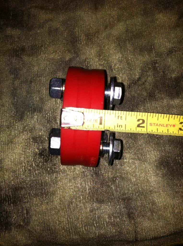

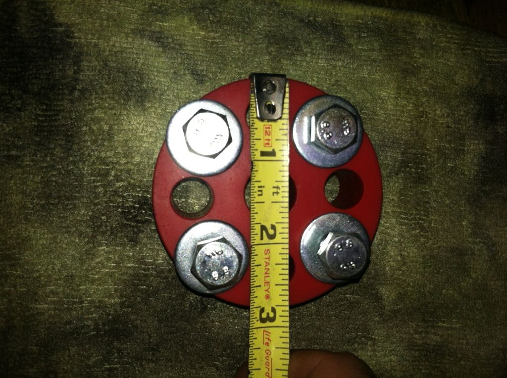

    My steering knuckle. 12/88 production date late model car but no airbag
    The car has a stock steering rack with no powersteering.
    I would like to do a e36 rack swap down the road.
    Is this the correct steering guibo? Purchased from Ireland engineering
    Project

    • frankie591
      • Feb 2012
      • 545
      #62
      seriously just bolt the 2 halves of the linkage directly together. Easiest solution, and best of all its free!
      • SkiFree
        • Jun 2011
        • 2766
        #63
        NO thank you, yikes.
        Iwantspeed... the skinnier steering coupler might be easier. But the thick one you have there should work fine if you loosen the upper spline and wiggle it up a hair.

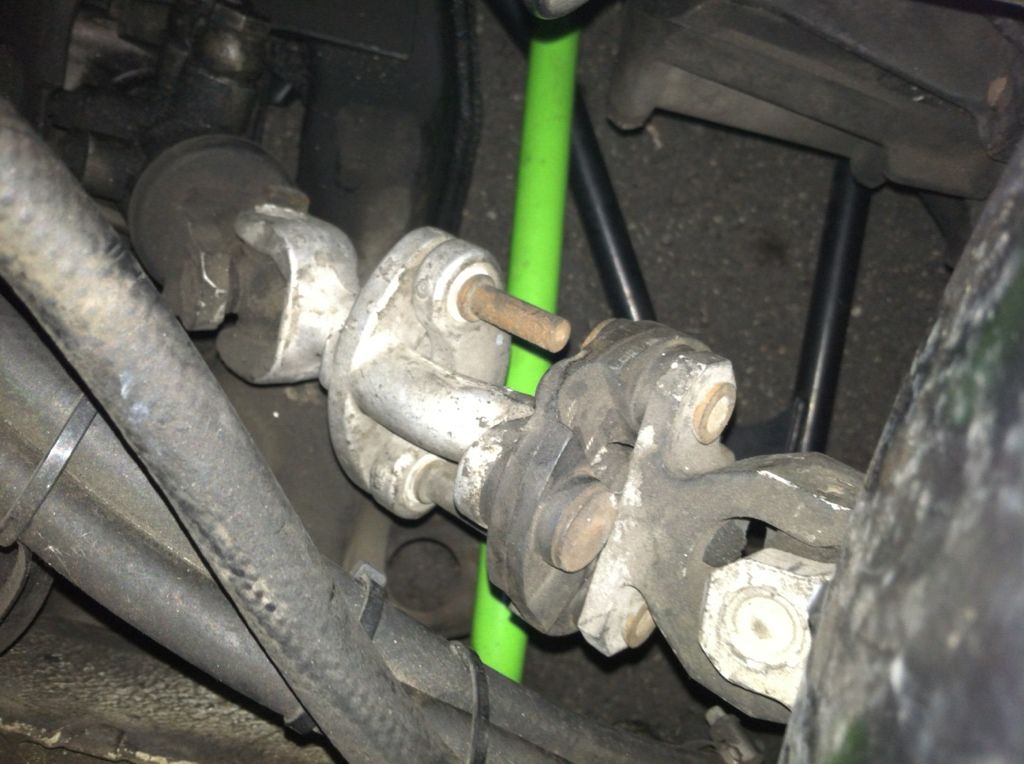

          Bump anybody to weigh in on this? I think this is a problem in my e30.
          Lots of slop/play at center and it take a while to 'load up' the wheels going into a turn.
          • nando
            • 34847
            #65
            if you have an ix, it's probably the steering U joint, not this flex disc.

              #66
              Thanks Nando, this one isn't on the iX ;)
