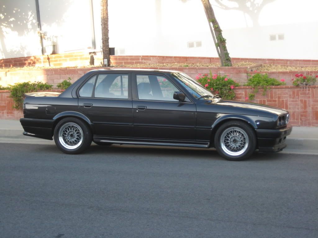

              I appreciate the help. I'm not sure if I should try vert rear H&R sport springs or even IX sport springs? If these OE sports actually stiffer in the front, I just don't see how stiffer front will raise/level the rear without reversed rake look. Or I'm wrong?
              Here is how I sit with 50406 kit. 50404.55 rears put me at exactly the same height.
              Black car is where I'd like to sit. Not that I have alignment issues or hate the current look, I do have rear subframe adjusters and was able to dial the alignment where I want it right. I just can't clear my driveway apron without getting off in the reverse on the angle and getting up on it on the angle. Oh and unload my passengers haha. Kind of annoying so I'd like to get her closer to Alpina B3 height which used M3 green dot springs btw.
