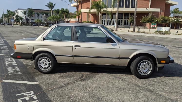

          Do you guys think the Turner site has an accurate assessment? I saw the pic in Mike.bmw's thread with the springs all next to each other and was surprised at how much shorter the H&Rs are compared to stock. I'll attach a pic of my car as is. It's pretty high but I wouldn't want to take more than an inch off.

            I have the H&R Sport springs on my car now, but can't give a totally accurate assessment since I later figured out that the previous owner had the car on M3 springs. But, see below for a pic of my car now on the H&Rs. I wish the front were a bit lower - I may go with one of the various drop hat setups on the front to get that extra half inch.
            The H&R springs are quite a bit shorter than stock but they are also higher rate, which means they will compress less than the stock springs when they are loaded.

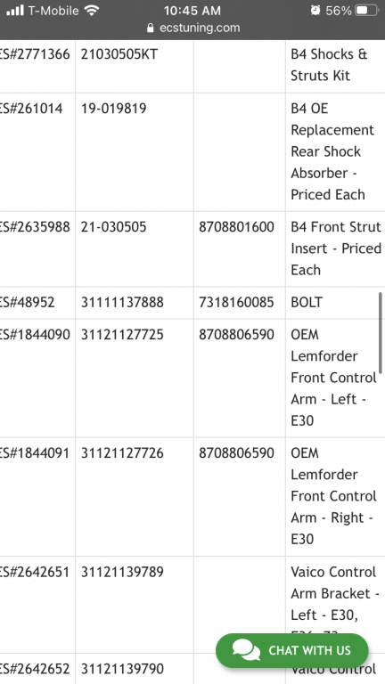

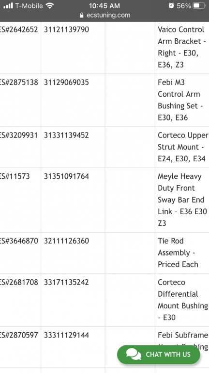

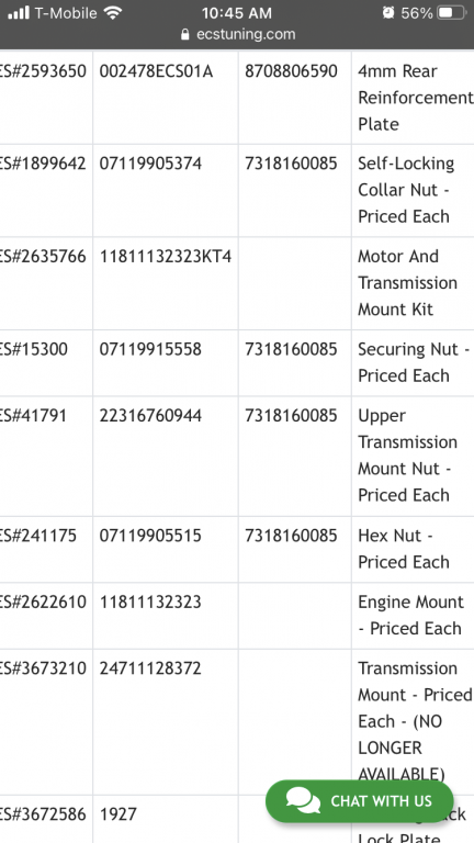

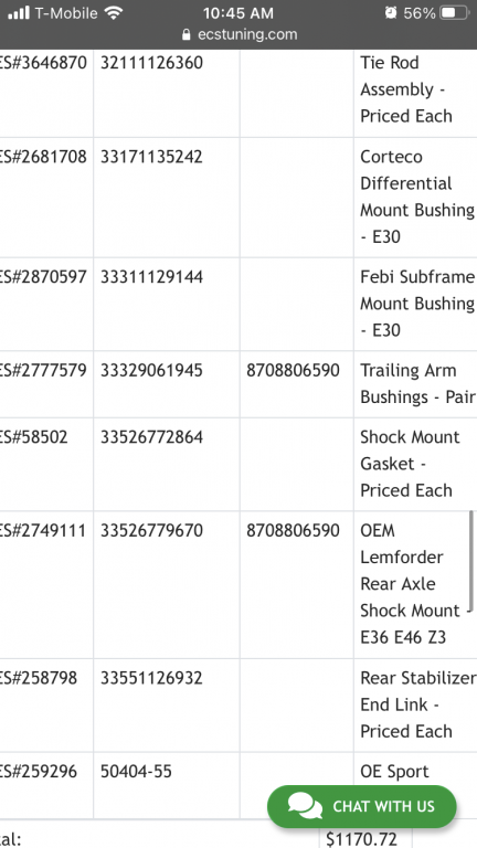

              I pieced out individual suspension items on ECStuning after hearing some bad things about the ECS suspension kits. and brought as my own kit (part numbers attached in images). Shop that did the suspension work told me not to pair the OE sports with B4 shocks cuz they’re apparently too stiff.

                      That’s correct, the shop said not to pair the OE Sport Springs with the B4 shocks. So I ended up returning the springs and my setup is the B4 shocks with the stock 325e springs. TBH I’m satisfied with the setup and wouldn’t go any stiffer considering I’m turning into an old man and my tolerance for bumps and jitters is decreasing every year
