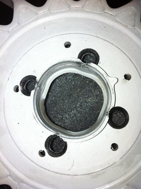

              was this my fault for using stock lug bolts? or do you think it was a bad fill and redrill?
              I don't see how it's your fault for using stock lug bolts, since that what he's using in his for sale thread.

                i did use hubcentric spacers he gave me, but i dont think it stopped the hub from warping.

                    Did you track with those wheels on?
                    • nugentnsb
                      • Jul 2011
                      • 444
                      All I did was mount them, and torqued them down with a breaker bar, and i tried to put center caps on but it wouldn't fit.

                        As I said previous is there a plastic or metal hubcentric ring in there that's actually the messed up part? It's hard to tell from the pic

                          When I bought the wheels he told me he welded on some hub rings, but after this happened I talk to him about it and he said there wasn't.
                            With a breaker bar? Maybe the fill and drill process weakened the metal, then you warped it with the breaker bar. What torque did you put the lug nuts at?

                              Originally posted by straight6pwr
                              looks like a terrible fill and drill, the lug holes look like they were drilled by a drunk guy.
                                if they were so weak that you were able to deform them by overtorquing the bolts, they were going to fail anyway. at least he didn't drive on them and find out the hard way!
                                Look at the holes, they aren't even round. they're way fucked up. redrilling is always iffy but those are definitely done wrong...
