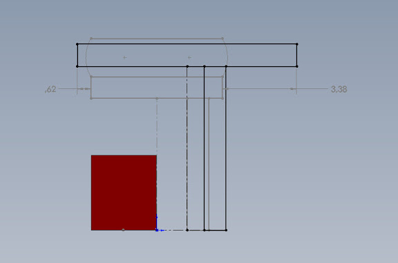

                                I drawn, in cut view (top half), the difference between stock (in gray) and keskin ( in black) on the rear. The inner side is on the left. In red is the hub. The 10in wheel is .62in wider on the inner side and 3.38in wider on the outter side. This is with 35mm spacer and considering et20.
                                I know that the tires are to big in diameter, but since this is a track oriented project, I dont really care. Bigger the better --> for grip...
                                What do tou thinks about this setup?
                                Will my wheel bearing last 2000km or 50000km?
                                Thanks!
