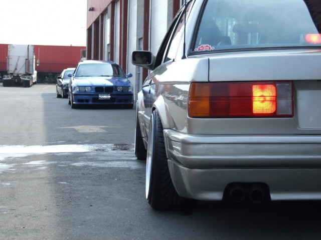

                Checked stancefactory and wonder if you can inform the specs on this:
                Love it sooooooooo much.....
                      17x8.5 +12 205/40
                      17x10 +12 225/35
                      Good times with that car...

                          Thanks Mystikal. I've got 16x8 et 11 and 16x9 et 24 wheels. What tyres and spacer I should use to get similar fitment to those?
