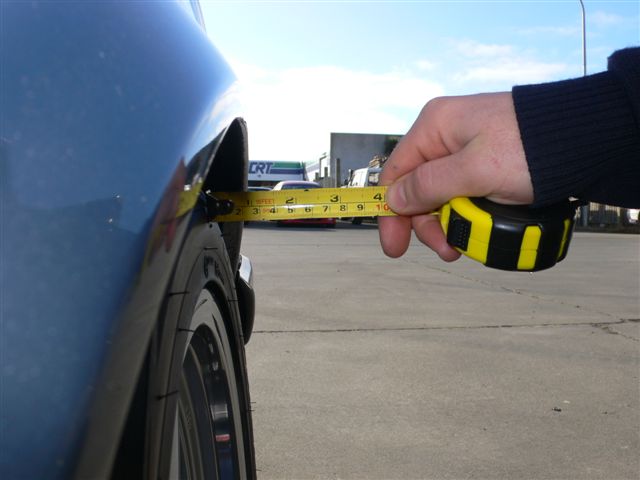

                          • drifty340i
                            • Oct 2004
                            • 1076
                            #283
                            Originally posted by Mystikal
                            Honestly, the setup you have is perfect for stock fenders. I have no idea how much you rolled under there, so the best I can tell you is just look and measure.
                            Jay
                            Thankyou Jay
                            They have been rolled a fair bit, i do have a ajustable subframe bushes that i have to fit but im not sure how much they will correct the camber problem? heres some photos to help explain. I want the tires right up against the guards so its fat a possible lol
                            sigpic340hp V8 e30 FINISHED!!!!!
                            Quick vid for ya ;) http://www.youtube.com/watch?v=vp5Eaf8xOgM
                            NEW One on the track :)
                            http://www.youtube.com/watch?v=K-AX5SzSLnk
                            Cleaning up some 911s and Jap turbos
                            http://www.youtube.com/watch?v=Ad79wsLdle4
                            • Mystikal
                              Wheel Fitment Expert
                              • 9602
                              #284
                              Originally posted by drifty340i
                              Thankyou Jay
                              Well don't do any kind of spacing until you install and adjust the bushings. Depending on the camber you want, you can either end up with a car that rubs the fender without spacers (i.e. 0 camber), or one that can run 15mm spacers (i.e. -4).
                              Jay
