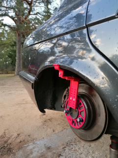

                              Someone recently pointed out this tool to me.
                              Wheel Fitment Tool on Etsy --- There are probably a dozen copies but it looks pretty well made.
