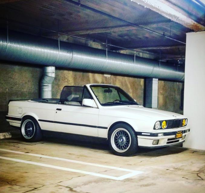

        #9693
        Originally posted by Staszek
        Ok cool I ran a 225/45R16 on a 16x8 et 23. I was lowered and had a slight rub in the rear. I raised the rear with some spring pads and that stopped. So you could go that size which is readily available and be fine if you are not lowered. If you are you may need a slight rear fender roll depending on how low.
        i have Stan's old wheels. just recently put in new koni yellows and H&R sports and added additional spring pads in the rear with zero rubbing.

          #9694

          Looking good!
