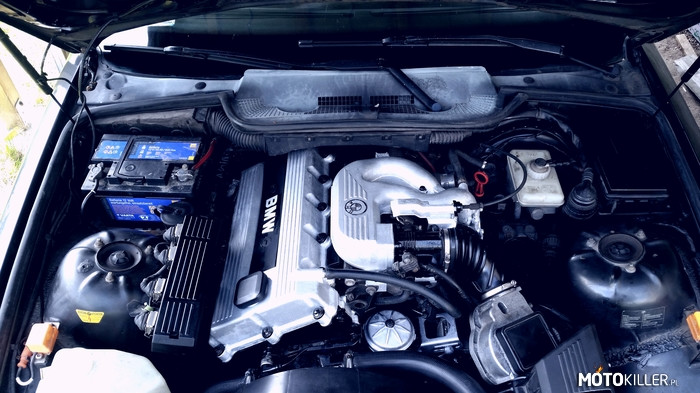

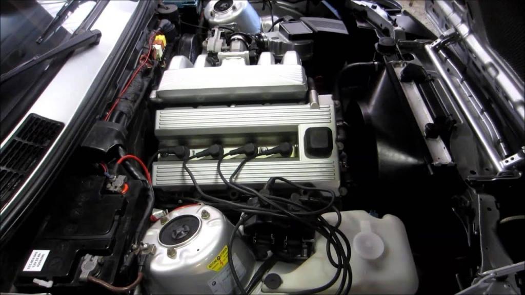

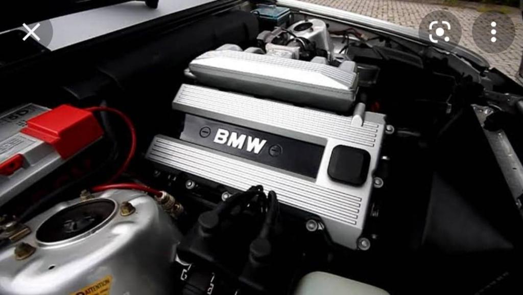

    As the title says, here's what i'm trying to achieve.
    m42 valve cover - Imgur
    Same photos are attached to thread.
    I like the top two the most.
    After prepping and cleaning the surfaces, What paint do I use? Assuming it is in fact paint, and not the colour of the metal?

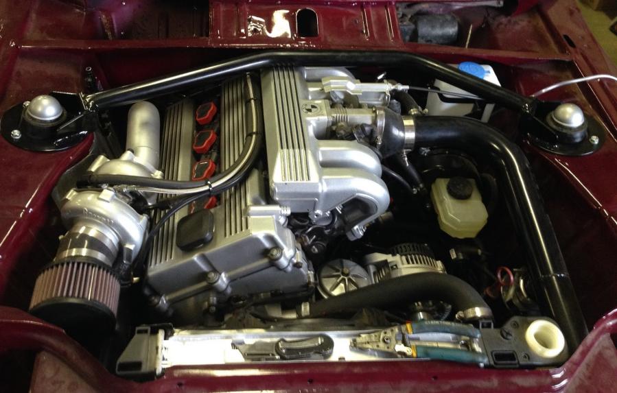

              rough sand and engine paint for comparison
Name:	KQwZvB9jnp4WJnduBL8svI1yqKndq3Z4VqXxu3obg_pkp2b4dZ2vdic0lWnOMIIPGyMGpt1V7o_7H9D-TNmynros232W8tdXm1Gp3WJyMf8ggDT0yLImPIrmaZm0eOb7x-6p-lurAg=w2400.jpg
              also think the blasted and clear look is the best of them all for aluminum.
