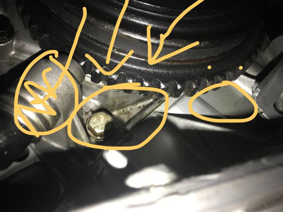

          YES! i lifted my car today and i suspected (from the thin film of fresh oil all over the center recess of the lower timing cover) that this may just be the case. as of now, i've slathered on RTV on the lower oil pan gasket, the horizontal gasket between the upper and lower timing covers and the VCG is good to go to come to that conclusion. i have to wait until several weeks from now to receive the O ring (already have the flat oil filter housing gasket) that i need to complete the OFHG repair. i pay $150 bucks a month to park in a very densely populated part of seoul, and the landowner has threatened to kick me out for the massive amount of oil that i've been leaking so as of now i'm dropping cat litter in the proximity of my car every time i drive to pretend that the leak is 'fixed'.
          pic attached shows the portion of the 'center recess' that had oil all over it. the sensor circled also had oil all over it, which i presume came from the same thing (but it was wiped off clean)

            Yeah, oil in the areas shown in the photo can easily be from the OFH. Honestly, the only other place I have ever seen it leak from is the butt joint discussed earlier up, and it is almost always just a drop or two every time you park. When the engine is running, the crankcase is under partial vacuum which keeps oil in, so whatever leaks is what settled inside in that area when the engine shuts off.
            The OFH on the other hand can make for an incredible mess since the leak comes from the highest pressure part of the system. Many years ago, a crapped o-ring led to puddles 10cm in diameter when parking, and that didn't include everything that squirted out when driving. Luckily I caught it early before the engine ran too low on oil, although that engine is long gone in favor of the built-up one I have now.
