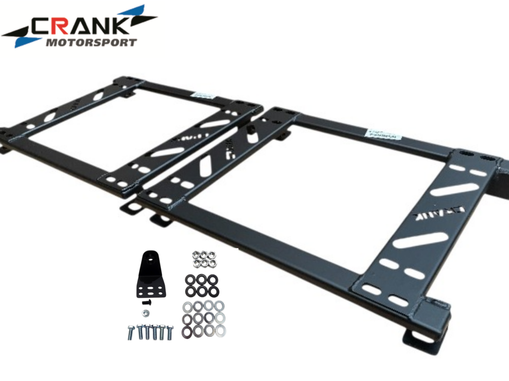

    Your options for aftermarket seats are typically bottom mount vs side mount. bottom mount generally speaking mounts the seats higher than side mount. but bottom mount also has much easier sliding mechanisms. Side mount you can typically get the seat very low, but is often fixed as there is nowhere for the sliding mechanism to fit. but like i said above, with the design of the e30 seat mounting system and floor you can get the seats quite low whilst utilising a bottom mound setup. Side mounts are often bolted directly to the floor for uber rigidity - no adjustment.
    here is a typical bottom mount sliding mechanism, you can see how low profile it is,

    Here is a typical side mount that i quickly found (not for e30 apparently, but very similar design) you can see that the seat can sit lower between the sliding mechanisms. but as above you, might not need it that low.
    Macht Schnell Motorsports Clubsport Seat Mount for Racing Seats for BMW 1-Series inc. 1M E82 E88 2-Series inc. M2 F87 3-Series inc. M3 E46 E90 E91 E92 F30 F80 4 Series inc. M4 F32 F82 A full turnkey seating solution for most race shells. Comes complete with mounting brackets, sliders, and adjustment mechanisms. Lightwe
