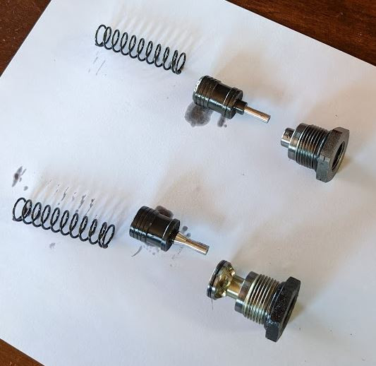

              That's true, but I think at some flow the capacity of the shuttle valve is overwhelmed, the pressure builds and the flow starts to bypass in the pump itself. There is some magic in the regulator poppit-thing in the pump and miniscule variations in the shape of the metering valve determine the bar rating of the pump.
              I had a Luk-20 pump in the N52 and so does the Porsche Cayman. The Porsche, being a mid-engine car, has much lower pressure requirements compared to the E90 so I bought a Cayman pump and swapped the regulator. It did wonders!!
              I found another car like a Seat that had the same pump with an even lower pressure but didn't bother.
