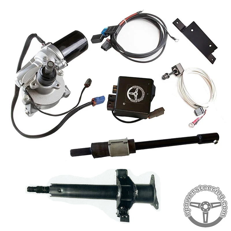

        The rally guys seem to like it for simplicity. if you do the electric steering column, then you still retain the manual e30 steering rack so it should still feel ok.
        There's a way to put an adjustment knob on the dash for assist level (instead of speed dependent as the oems do it). That seems pretty cool. Im not exactly sure how those electric assist columns work but being adjustable surely you can make it feel good.
        As for Prius. almost every car is elec power steering now, so you've just gotta find one that fits.
        here is a nice looking plug and play option for quite a few dollars.
        Electric power steering BMW E30, electric power steering for BMW e30, electric power steering conversion kit for BMW e30

          There’s a company that makes EPS kits for E30s now (link below). Costs quite a bit though. You also have to surrender your current steering column as a core.
          For the people complaining about the “feel” of EPS, this kit also lets you adjust the steering boost.
          Electric Power Steering Kit for the BMW e30 Finally, after being requested enough times by our customers, we have put together the BMW e30 electric power steering kit. This unit is made for the the non-tilt steer model. This power steering module is installed underneath your dash. The complete EPS system and steering column only weighs

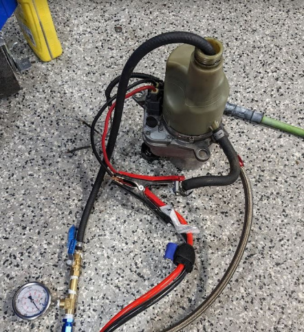

                    I'm working on the Volvo conversion. Playing with the pump here to get maximum dead-head pressure.

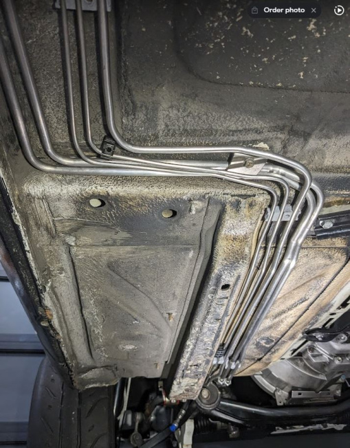

                        Originally posted by Panici
                        Dream setup would be trunk or undercarriage mounted components for an even cleaner looking engine bay.
                        Great idea! ;)
                        This is PS supply and return, TWO rear brake lines and a single fuel supply.
                        The engine bay will have two 12" flex hoses going to the rack, nothing more.

                          Originally posted by hoveringuy
                          Great idea! ;)
                          Awesome! Build still in progress I presume?
                          • hoveringuy
                            • Dec 2005
                            • 2754
                            Yes, it"s multiple things, all precipitated by the dual rear lines for the Mk60 ABS.
                            Now that I have all the lines in I'll get the rear subframe back in
                            The pump is 12" tall so it will be recessed into the trunk floor so the motor will be below and the res will be above. Thats the idea, anyway.
