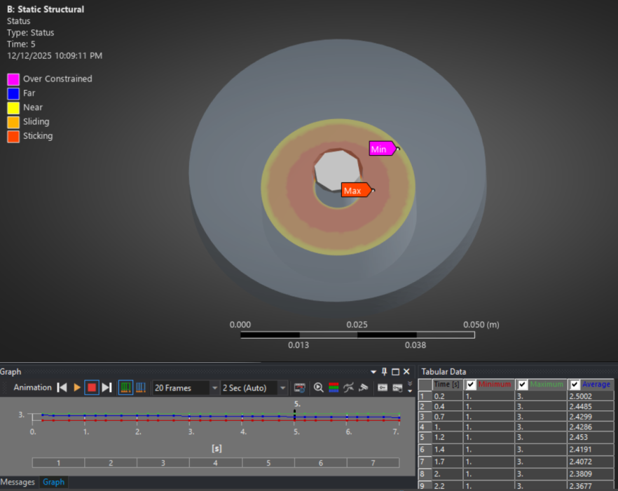

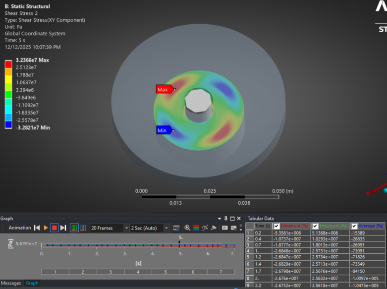

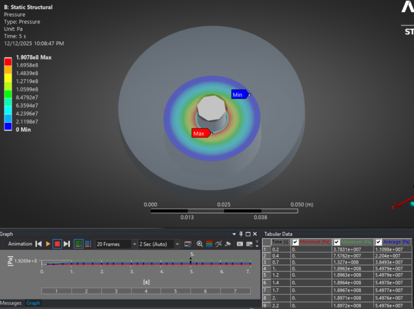

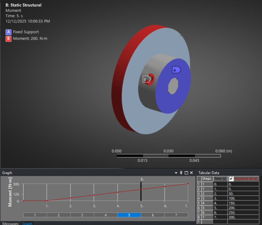

                      Never one to not investigate, I decided to run the analysis on the bolt clamping pressure and how that correlates to contact pressure and subsequently shear stress on the intermediate shaft. Using a static friction coefficient of .8 and a bolt pretension of 48000N which pretty much equates to 65Nm on a grade 10 M10 bolt. I assumed the bolt head to be 18mm in diameter to define the clamping pinball range of the "bolt" (beam element).
                      I fixed the "intermediate shaft" and applied a ramped moment from 0 - 300 Nm over 6 seconds. A stock M20 will put out about 220Nm of torque.
                      Sure enough, shear stress is an order of magnitude below the contact pressure confirming that the surface contact provides enough pressure to keep the gear from spinning.
                      I stand corrected!

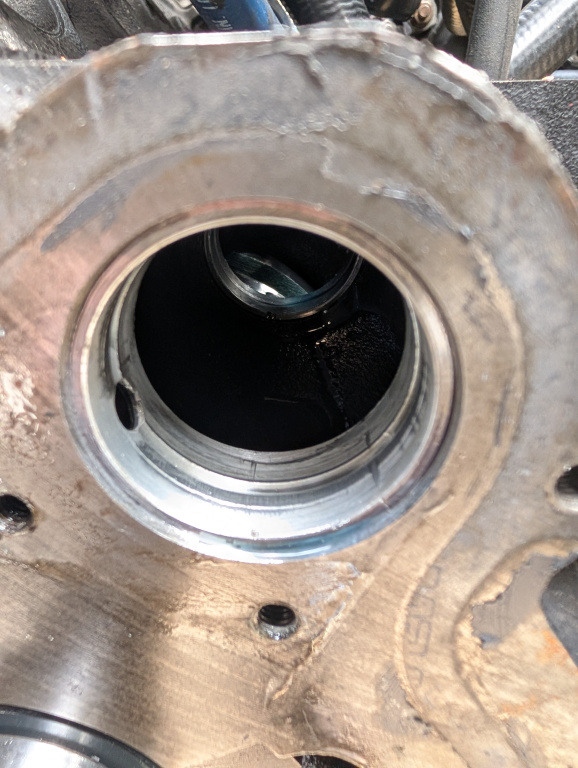

                        Pulled the front apart and the intermediate shaft was locked up. The oil pump shaft spins freely but the intermediate was not moving. I was able to pry it out with two pry bars on either side of the retaining groove. My clearance when I honed the bearing was clearly insufficient.

                              I tried to spin the shaft today and it had no intention of turning. I took out the mating gear to the oil pump and was able to use a 6 mm socket to turn the pump with my fingers.
                              Intermediate shaft was stuck and was difficult to remove. There was bearing material stuck in the oiling groove.
                              Varg, it's the engineer in me. Had to be done. I did modify the analysis and run it again with more realistic numbers, ( 35000N clamping force and a few other modifiers to bring the results in from the fringe) even still, if the pump consumes .5hp, thats equivalent to around 10Nm at 400RPM-ish. So if it sees 20 Nm that is 15 times less than what was calculated at slip. What I will say, however, is that there is clearly a difference between analysis and real life, because the pin sheared and the bolt failed due to slip, so my coefficient of friction was clearly off or else the engine would have stalled without breaking the gear.
                              The S55 crank slip stuff kind of proves my point. Compressive force is not enough. Why not pin it and never worry about it? Every aftermarket solution is some type of keyed component that doesn't rely on friction.

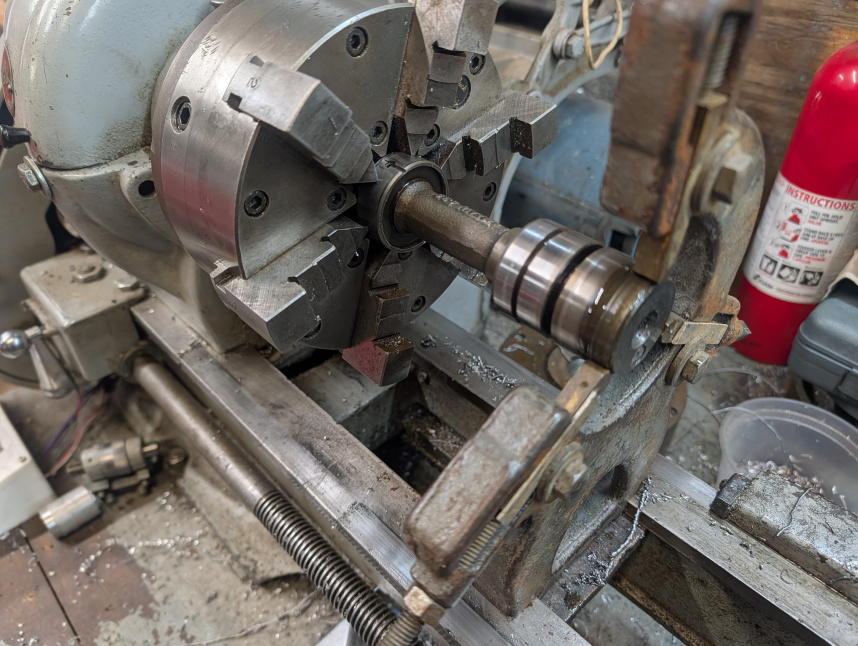

                              Also, I had to use an easy-out on my lathe to get the bolt out
