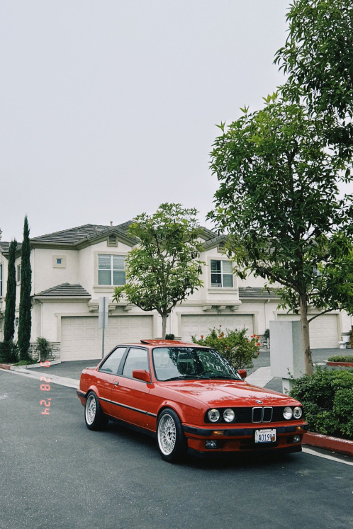

    I used e90 drop hats in the front and I added a 5mm pad to the rear with my h n r race springs
    I rarely scrap anything
    I think it's perfect

      Looks great. I'm going for handling over looks, so looking for the height where the suspension works best, then as low as I can go hitting the oil pan.
      Do you just have the drop hats in the front? Are there spring pads? Do you just have a 5mm pad in the back? Or do you have them stacked in the rear?

        yes, oe spring pads in the front paired with drop hats and an aditional 5mm on top of the oe spring pad in the rear
        people have proclaimed faster autocross times adding a lil height to the rear
        probably better at lower snapper courses like auto x over higher speed stuff with this kind of setup
