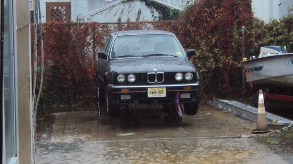

Here are some pics.
IX in pictures had water up to the front seat. it does not start. I was trying to get it ready for the winter so i can put the vert away to work on.

OP, Sorry to hear about your misfortune, If the water was "fresh" I say strip it down, pressure wash everything, apply liberal amounts of Lysol or some other disinfectant to EVERYTHING and let the cleaned parts dry-out until bone dry.
I mean for the most part, everything *should*be ok... ECU may be shot, you can try to dry it too idk.
if the engine flooded out, drain all oil etc, pull plugs blow water out of cylinders with compressed air, squirt in a little WD40 or something and refill with fluids when done try starting it...
you have a lot of love and time in your e30, so invest a day of labor and see what happens.

Poke the drains free under the rockers and trunk, dry it out and call me to help diag your electricals if necessary. You still have my #?
