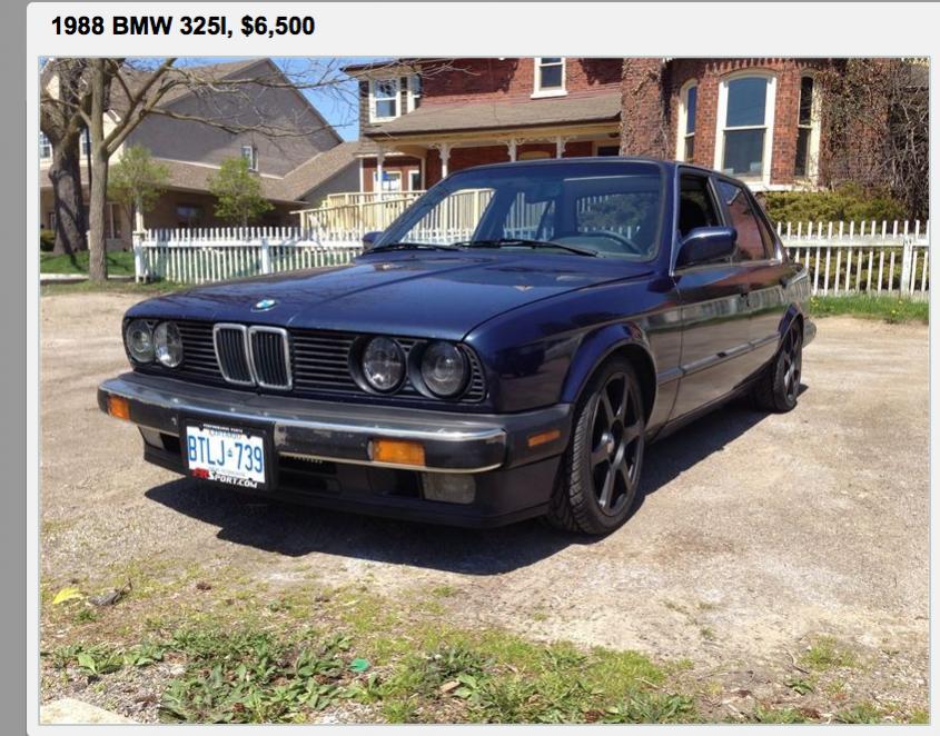

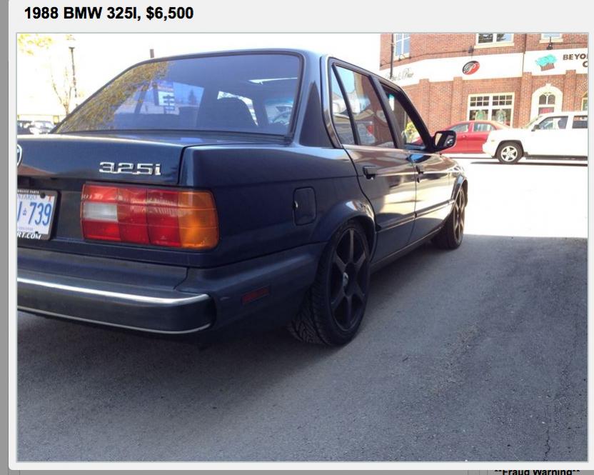

    Hey guys,
    Sorry for the n00b question.
    Up until yesterday, I thought I knew the difference between pre-facelift cars and the facelifted versions.
    Pre-facelift:
    Smaller tails
    Metal bumpers (North America diving boards)
    Higher rear arches
    Facelift:
    Larger tails
    Plastic bumpers
    Lower rear arches.
    That was until I saw an e30 up for sale with larger tails, lower rear arches, and Metal bumpers (diving boards)
    [see attached pics, also I'm not interested in buying this one, but was intrigued by the bumpers]
    Was this combination ever offered? Or is this a custom/collision shop special?
    Cheers!
    P.S - Are there any mechanical or structural differences between early and late?
    I know gas tanks are different, airbags on some cars.
    '87 BMW E30 325is Turbo
    '99 BMW E36 M3 - - - '98 BMW E36 328i
  • jlevie
    • Nov 2006
    • 13530
    Most likely that was an 88 (9/87-8/88 production). It is in between the early and late models.

        Yeah, definitely an '88. Cool fact: there are five 4dr 1988 E30s with that colour combo in North America (at least, five were made). I own one other.
        You'll notice the valances are also different, identical to the plastic-bumpered cars. Late models also have a different intake boot, headlights (interestingly, the 1990 had the shittier early-model sealed-beams). Obviously the plastic splash shields are also different.

          Interesting!
          So these in-between models came from BMW this way. :o
          I did notice the facelift valance, and was very confused to see it under a metal bumper.

            Yes. The 88 had everything late model but still used diving board bumpers.
