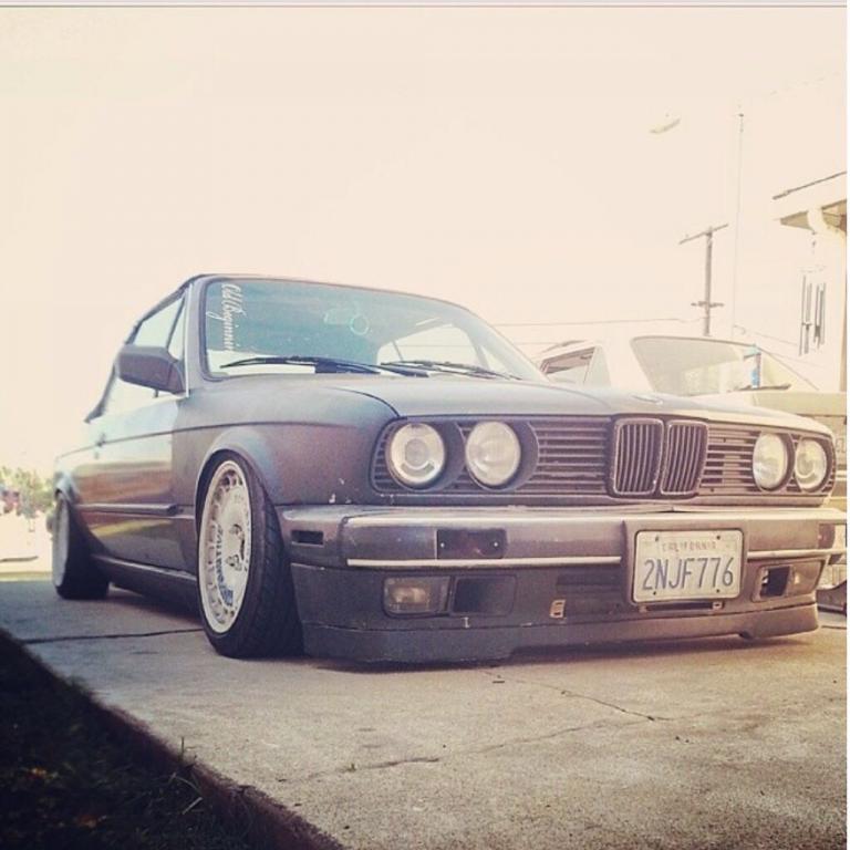

                          #57
                          Enough talk about bumpsteer the point of this thread is your all wrong, key to driving low
                          1. No skid plate (gets in the way of more low)
                          2. Frankenstein coils with high spring weights
                          3. Stock up on m20 oil pans
                          Proof is here, Los Angeles daily driven with no skid plate
