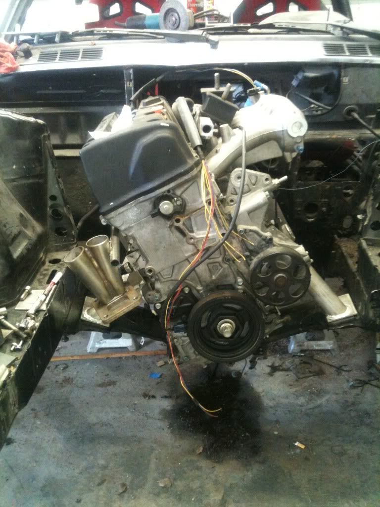

      Apparently had issue with the board for using a dry sump and had to remove the external oil box, appealing the decision.. was done for oil starvation purposes and apparently they felt the engine is quite long and it made sense to go dry sump with what looks like a huge oil canister. Fined for the first round of I believe a 6 hour race for advantage

                              #44
                              IMO an e30 should be light an agile (this coming from a rally fan)
                              Bmw raced this plat form with powerful 4cylinders and racing transmissions for a good reason.. S54 is a beauty but track wise..
                              I'm building a rally e30 and thinking a built 4cylinder says "Legendary group B" all over it.
