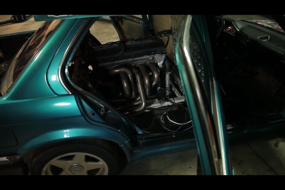

    So who's going to make a mid engine S54 powered E30? Any takers?
    • reelizmpro
      • 9509
      #47
      Kinda...
      88 M3 - LACHSSILBER/SCHWARZE
      • Andy Mechnic
        • Jan 2015
        • 117
        #48
        That's pretty close.
        Gives you room for that sweet engine driven fan.

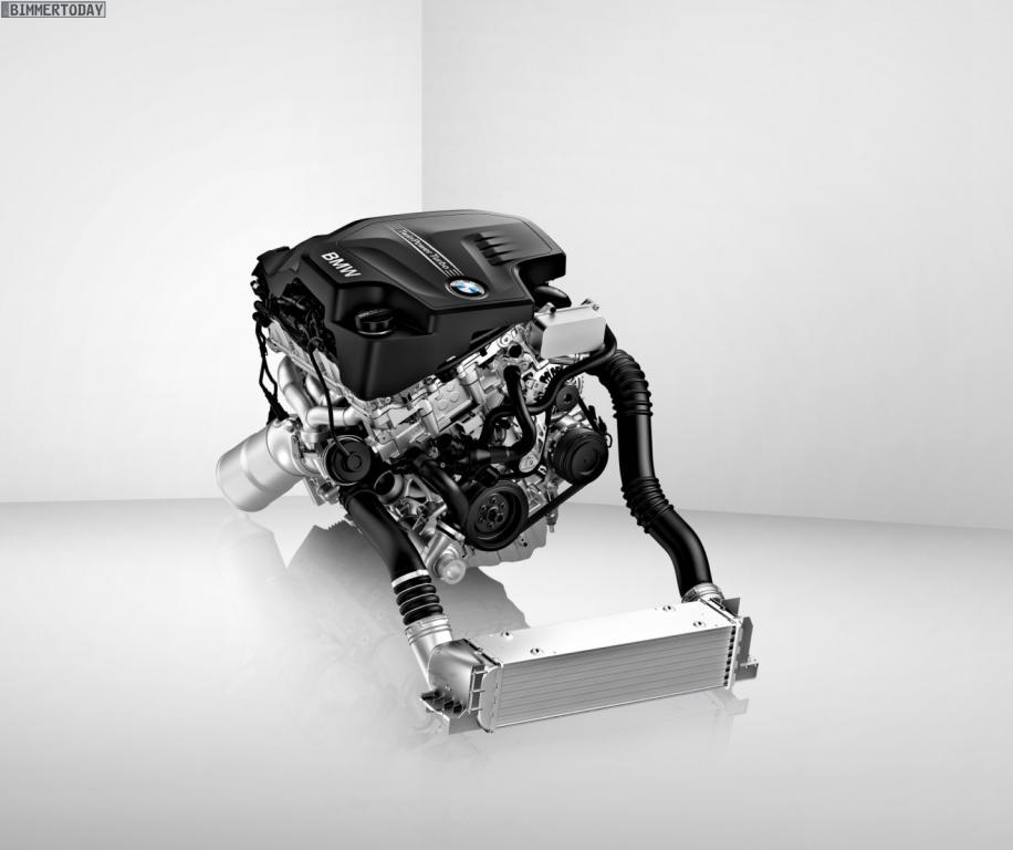

                      What about the N20? Does anybody know how to tackle the electronics or know what is needed to make it work?
                      • mr2peak
                        • 2388
                        #56
                        ECU, harness, sensors, key fob detector. It's just a wiring problem after than. Most likely similar to an S54.
                        Lots of potentially expensive electronic components. Installing replacement fuel injectors and other seemingly basic parts usually requires an ECU flash to recognize and optimism the parts. Look at 135i ownership experiences, lots of $ from what I have seen. Undoubtedly a great engine, but it's packed with technology that isn't exactly DIY friendly (right now).
