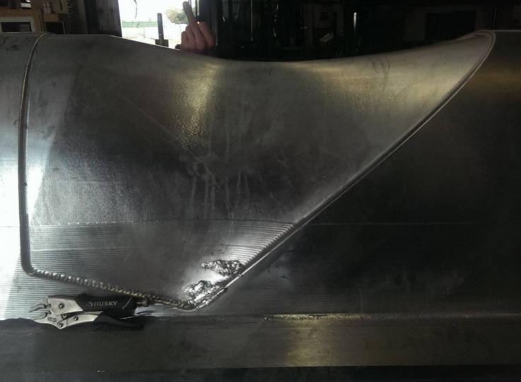

      Somebody (middle finger guy) rammed a face mill into a 10,000lb die at work. Taught myself how to weld cast zinc:
      It took an industrial propane space heater 4 hours to get it up to 200deg F. blasting directly underneath it, and it was warm for 2 days after that.
      Miller Syncrowave 351, only had a WP20 torch so I had to keep the amps at 250 or stuff would start to disintegrate. 1/8" E3 Tungsten, zinc brazing rod as the filler. It's much more tricky than you would think, melts around 750deg then poofs into a white sooty fur that covers everything right after that. All the while it's constantly off gassing zinc vapors that you hope your respirator will take care of. But I drink a half gallon of milk just in case.

        Zinc poisoning is no joke, it freaking sucks, you feel horrible for days
        -Christian

          Zinc is no joke. we do a large amount of galvanized welding in our shop. I got really good at holding the run as far away from my person to stay out of the plumb.
