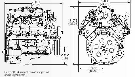

              There's no doubt that they sound good. Some of them look nice too. As for the engine, that's narrower than I expected from the pics, probably nearly identical in size to an M60. The shape makes the width more of an issue since the point of maximum width is lower than it is on a domestic V8.

                Yeah I was poking around for similar size motors and the m6x came very close to the f136. What you mentioned does seem like it would be an issue, not sure if the motor would sit low enough. I’d be worried about getting the transmission to line up correctly.
